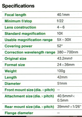

For the EL Nikkor 40mm, does this tell anything?
Yes, look at the "Original size" as they call it. It is the diameter of coverage, thus just full frame.
This is what I meant by referring to it behaving as the Rodagon WA of same focal length.
