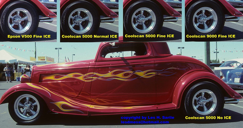

And fortunately for us, Coolscan+Nikonscan doesn't double the scan time when enabling ICE. And it's not as soft as say the Epson's . . . even when not using ICE . . . 😉
Coolscan 5000 scan res with and without ICE on Fuji RVP - Velvia 50
Fuji RVP50-03_18 Coolscan 5000 by Les DMess, on Flickr
V500 different scan res with and without ICE on Fuji RVP - Velvia 50
Fuji RVP50-03_18 Epson V500 by Les DMess, on Flickr
