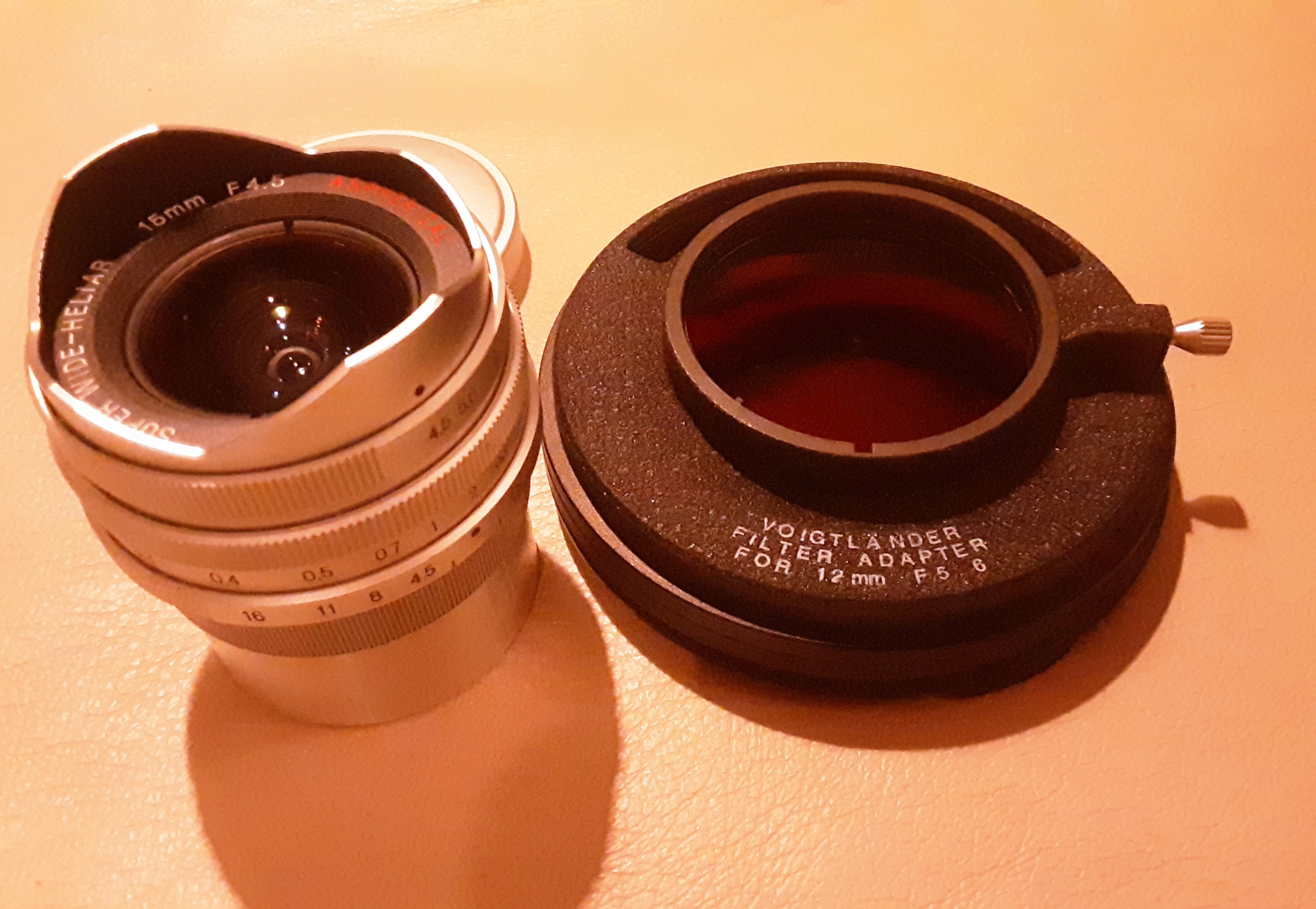

The original advice from Voigtlander was to use their custom 12mm f5.6 and 15mm f4.5 interchangeable front mount push fit (screw lockdown) filter (pictured).
The front filter inconvenient trade off required is an 82mm. Rather extraordinary compared to the V2 at 52mm however there is no benefits in optical formula of one over the other.
The V2 loses the ability to be used on Barnack and other screwmount LTM cameras. In this way, you can shoot infrared ultra wide angle 15mm on a Barnack (if you have/can find).
