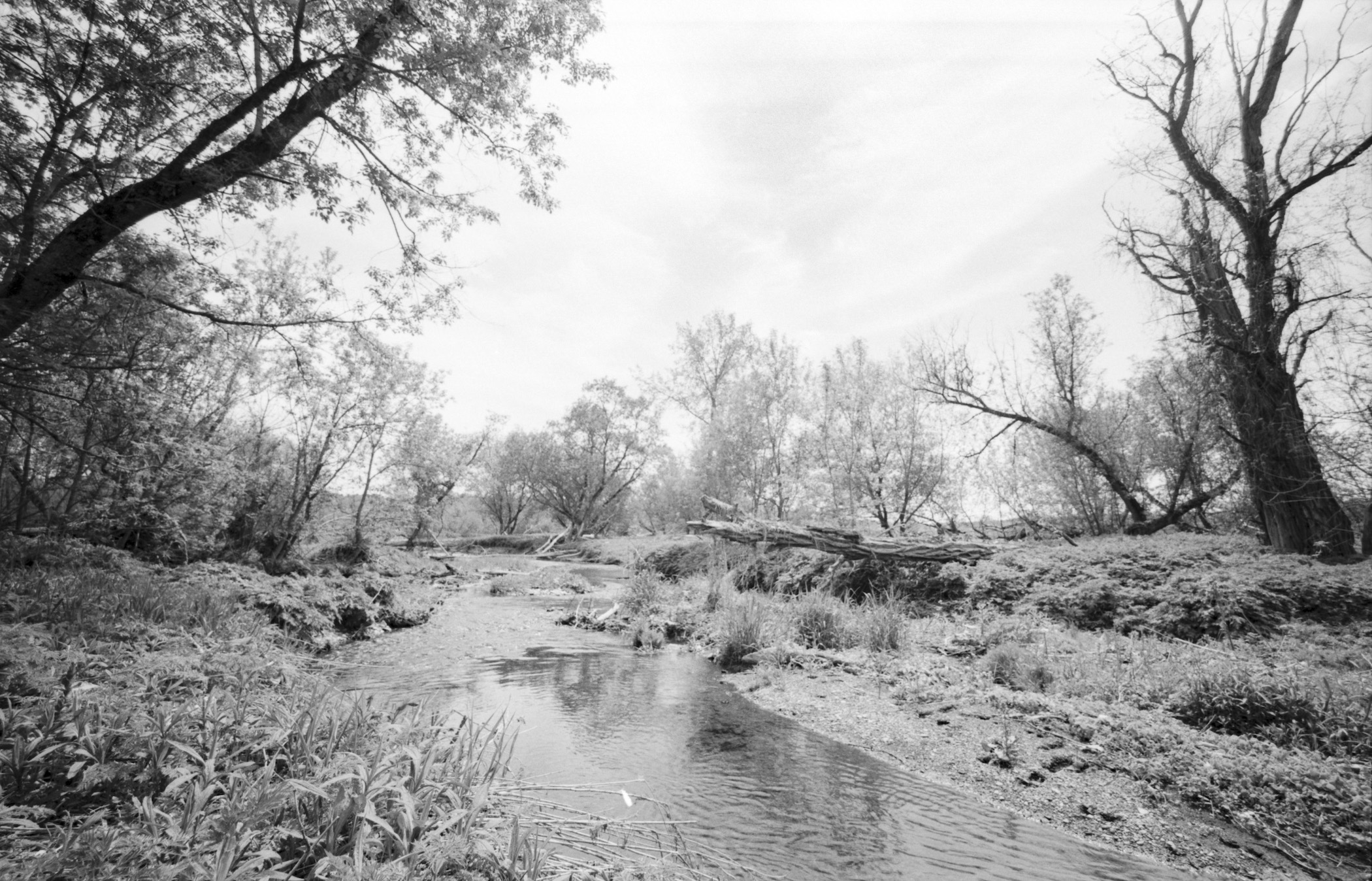

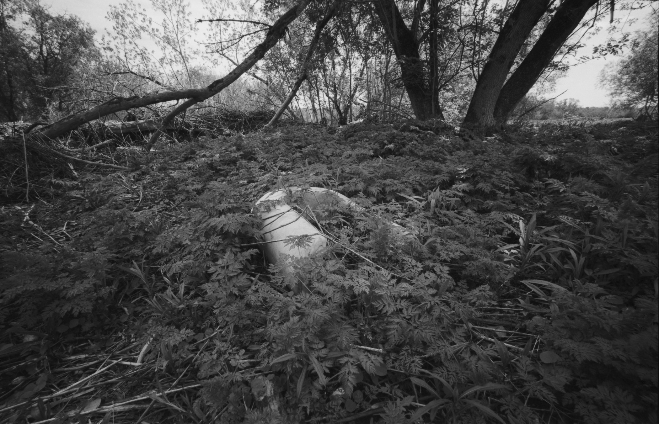

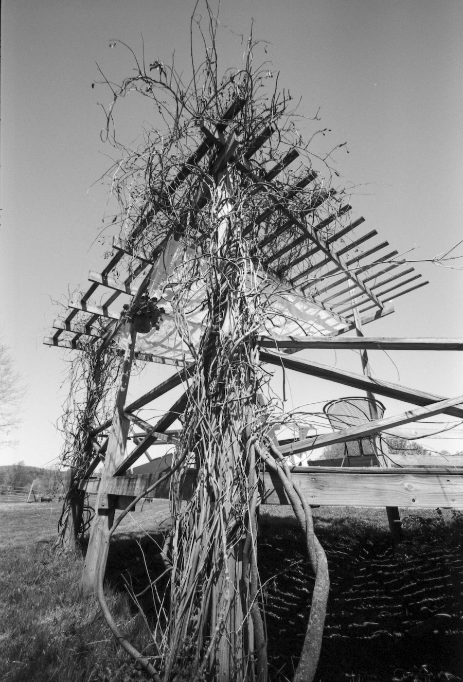

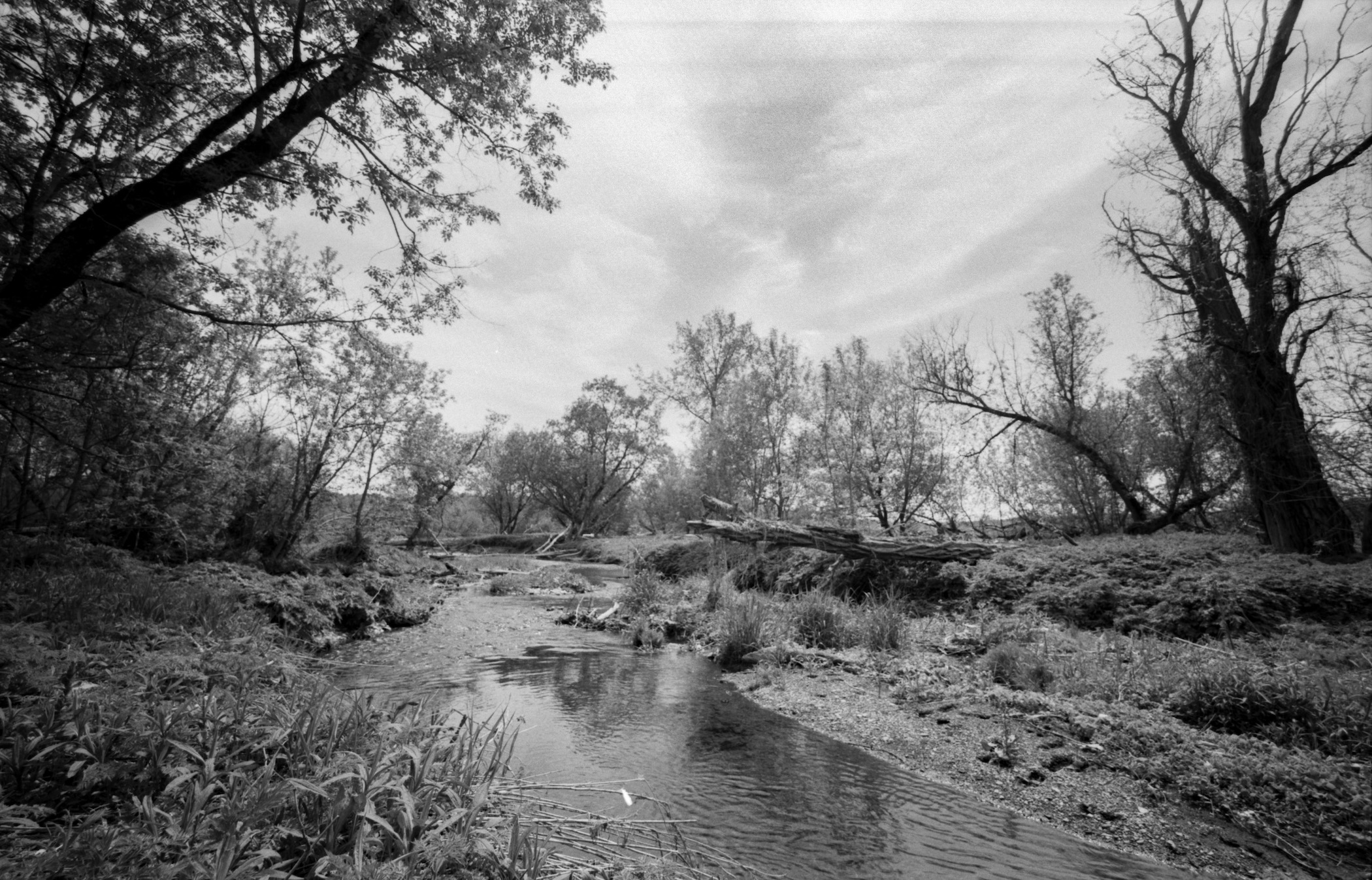

I am having trouble with this lens, I am pretty sure it's me, but maybe not. But, I can't see what could be wrong with the lens itself.
I have severe overexposure, I am using my Sekonic spot meter. If there is sun, it's blown, any light in the background, blown out. I've been keeping it at f8 as suggested and using the either the RF for focus or using the set it and forget it since the DOF is so massive. The first roll I think I used f16 more, they were actually less bad. One came out fairly well with out PP, it was in the shade.
Should I use an ND filter? K2 filter? The problem is though that if I add contrast I lose shadow detail and clipping. I am not sure what to do. Maybe it is the film? I can't see why though, I'm using Delta 100, and the images taken with another lens are fine. Should I just under expose 1 stop as a rule?
Any input would be greatly appreciated. Thanks!
Image 1 - no PP
Image 2 - PP, looks like crap
Image 3 - 125/f16 not too bad
Image 4 - not too bad with no PP

I can't see the problem - your exposures are just looking fine.
Be proud to own that Leica with 15mm lens. By the time : does Leica have an own 15mm lens today - I remember that case : more than 9500,- bucks. .....?
Of cause you'll get hard contrast even more by using 15mm outdoor.(caused from the angle) but that isn't solved with metering - that has to be solved in darkroom (via printing) if you own no darkroom it has to be solved via developing ( low contrast developing ) it is indeed the best way (solved before printing). Ok may be - you devolope your films not by yourselfe? The oportunity with filters is allways not the very best way.
By the way do you use a center filter with your 15mm?

I now remember why I don't do so much B&W landscapes any more. The 30% sky and 70% foliage (which has really no contrast) is problematic. I only use the spot meter on what I think is 18% grey. By saying do pull processing I should develop it for less time, so shadows develop but the highlights don't get a chance to go crazy.
Are you seeing the same exposure problem on your end to with other lenses? Such as a 35 mm? I think the problem is either with your light meter, your metering method, or your shutter. I assume your aperture blades are working correctly.
Aperture blades seem to be fine and the camera has had a CLA not long ago. But, I do think my metering could be better. I took some with my 35mm in the same location and I'll see what they look like. I think perhaps it just doesn't handle these high contrast bright conditions. Onward.... Yes, 99.9% of images are not what we expected them to be, I like to put a lens through it's paces to see how it ticks.
I think the lens, the camera and the light meter are likely fine but you are still learning how to properly use that spot meter. Tell me: In the backlit scene of the stream, where did you aim your light meter? To my eyes, that looks like difficult lighting, and if I had to guess, I'd think that there was easily a 7 stop difference between your shadow areas and the sky. You've managed to recover detail there during the scanning process, but it looks strange because tonal values in the sky and deep shadows are compressed. This isn't like shooting digital, where digital sensors are linear right up to the point where they clip.
Photo of the trellis looks pretty crisp by comparison and no wonder: Contrast in that scene looks far less challenging, perhaps as little as a 3-stop variance.
Definitely a user issue! I think I set the spotmeter on the reflections in the stream. I always try to find the middle grey in scene. I'm most likely not good at it. 7 stops is a lot to cover and have everything come out right. It was probably around 2:30 in a flood plain with some shade. I have read that this lens can blow highlights on digital with bright skies I think landscapes in B&W are challemging in general. I shot some more and we'll see when I developed it! Thank you for your expert insights.

Spot meters are great tools for quickly measuring the contrast of a scene: Besides shutter speeds and apertures, your meter likely also displays an "EV" (Exposure Value) number, and that can be super-helpful! Because with a change of 1 EV represents a 1-stop change in exposure. So by measuring not just a mid-gray area, but also the brightest important part of the scene and the deepest shadows where you hope to retain some tonality, those EV numbers will tell you very quickly what you need to do (or whether it's going to be "impossible" without more advanced technique). Beyond about a 5 EV contrast range (b&w negative film, somewhat less for other types) things get trickier.
