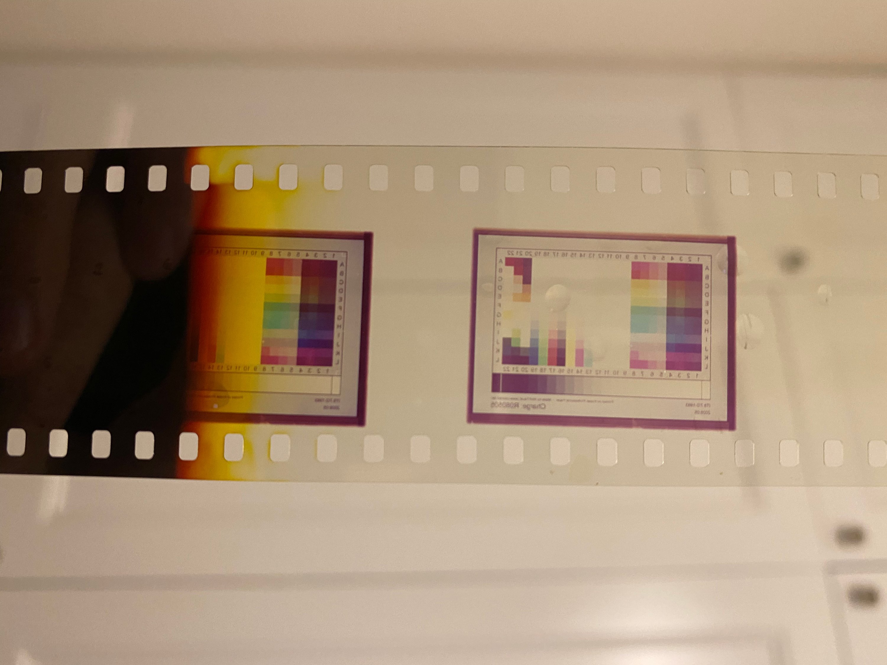

I've finally acquired the Vision3 500T, the 2383 and ECN-2 developing kit but I have not got the ECP-2 developer though for my first attempt I will just try the ECN-2 or maybe some old C-41 I have. I'll send an update how it goes as I've got some time to try it now.
I took a photo of an IT8 test pattern and successfully printed it onto the Vision 2383 developed in the Cinestill CS2 ECN-2 Kit and despite some colour correction needed during printing the final exposure shows some hope.

Did you ever nail down your process for 2383 to get results similar to the end product of a lab using ECP-2D chems? I have 2383 and I want to contact print 250D cine film onto 2383 for an accurate cinema look. My good friend has the official kodak ECN-2 chem kit. Can i just substitute the developer and get a look similar to ECP-2D?
thank you!
