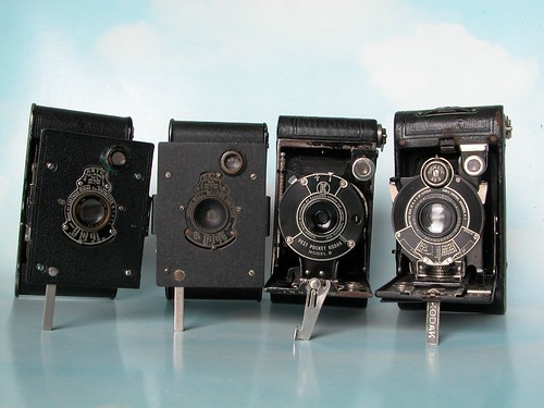

You might consider 127 folders. The Vest Pocket Kodak Autographic is a nice one. 127 film can be bought from freestyle. You may have to find a lab that can do it, or get a spool for it (adjustable "universal" reels, like in the patterson universal tank, will fit 127 film).

These are really cool cameras. They cost between $20 and $50 on ebay, and are very simple to operate, and quite neat looking. Very tiny too; they fit into a small pocket (as the name suggests :wink:). They come in versions with different lenses. There's a "low end" model with a meniscus achromat (you can tell it by the fact that it looks like it just has a glassless hole in the front, but the lens is actually tucked away behind this hole and the shutter). Then there's a higher end model with a Kodak Anastigmat f/7.1 lens; it has an obvious glass surface on the front. Both take nice pictures and both will give you a nice vintage look. I have several of these (plus a Contessa Nettel Piccolette, a similar camera but German made). Stay away from the VPK model B. It's a piece of junk compared to the others.
The VPK (anastigmat lens) and VPK (meniscus achromat) are on the left; the junkier (IMO) model Bs are the two on the right.
