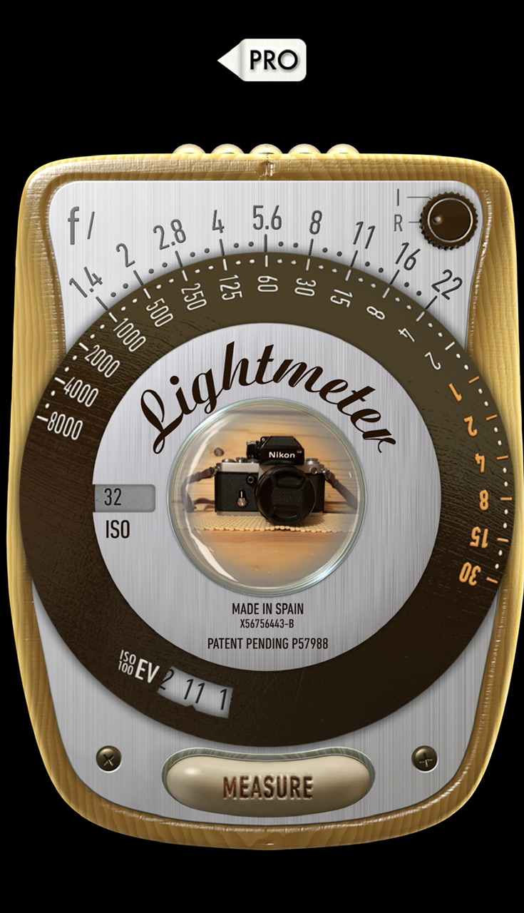

I use this iPhone app called mylightmeter, pro version.
It`s very accurate.
You need the pro version because the F2 is a pro camera...!
