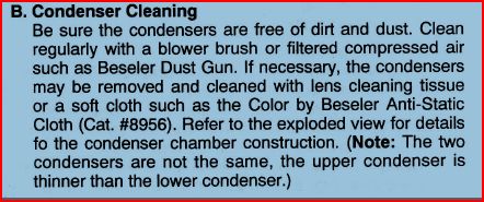

hmm. so does the bulb need to be closer or do i need to do something with the condensers? they all appear to be in the correct position. condensers are belly to belly and look as thought they fit in perfectly.

I don't think the lamp is adjustable in the 45. You might want to double check the condensers.
