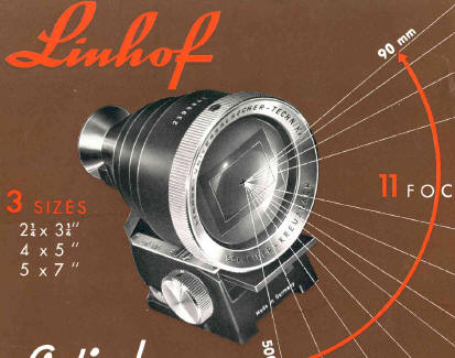

The fanciest device I know of is the Linhof Optical Multifocus Viewfinder.
It's an optical device with adjustable focal length and a calibrated FL scale.
