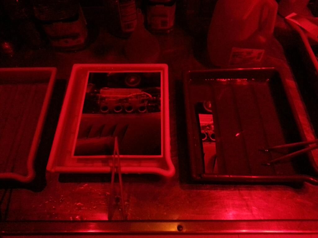

I've got LED safelights, and it's bright enough to shoot with my cellphone camera in the darkroom. If it's bright enough for cell phone shooting, any digital video system should work.
Cell phone snap:

[video=youtube;-psmDgTu1Xk]https://www.youtube.com/watch?v=-psmDgTu1Xk[/video]
with my cell phone cam.
