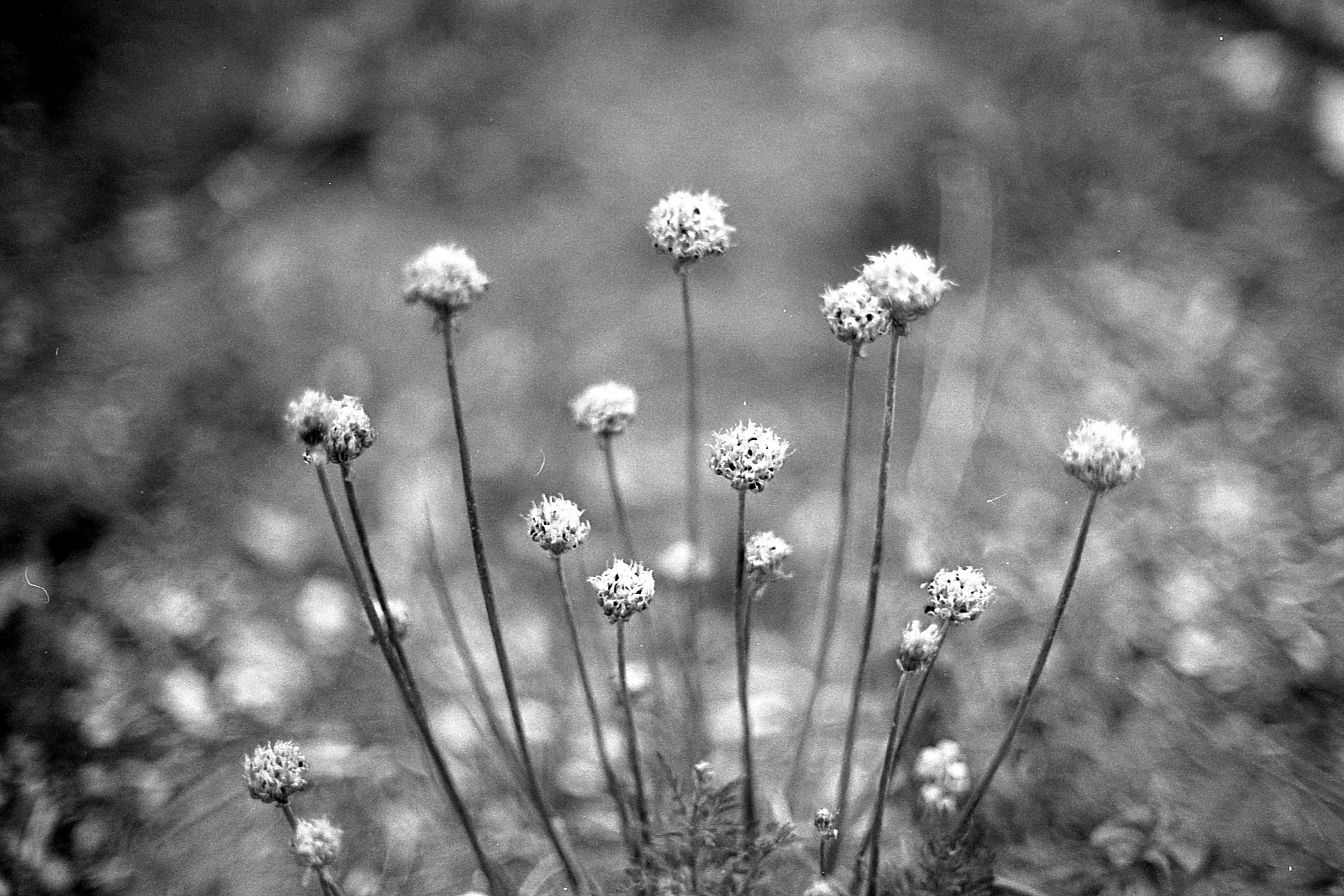

No problem. Tried out your formula last night and got great results, even with a 2 stop push.
