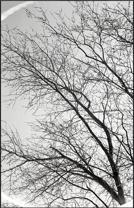

Hey Last week I bought a Camera so I tested it last weekend and got the film Developed yesterday. But there is a small problem and I want to see if anyone knows what could be causing it.
In Almost all pictures there is a light leak in the bottom left corner, but it's just a small thin line. But the strange thing is that it is not in all the pictures and it is both in pictures taken in the dark with flash and in full sunlight. In Some Pictures is more visible than in others.

The Camera I am using is Samsung Vega 140s Quartz Date
Not like any light leak I have seen.
  • Is the mark always in the same spot? Exactly?
  • Is the mark present on the negatives?
My first guess is it is a problem with the equipment that made the print.
Yes Always in the same spot in the bottom Left corner just more or less visible. and in some pictures not visible at all.
Yes the Marks is present on the negatives also.
Might be a developing Problem , but I did develop a disposable camera at the same time and there was no problem With that one.

I did just check and no there is only a mark on the image not outside.
I've been trying Some different zoom Settings and it seems to appear on most of them, because I don't remember fully what zoom I was using in every picture.

So - the mark is on the negatives, doesn't go outside the frame and is always in the same spot.
Well, it's not processing or printing.
It looks much too defined/focused to be a light leak as we know it. It can't be debris in the camera as it is white, debris in the film gate would show up as black.
I'd love to know the cause. So far the best candidate is Space Aliens did it.
I wouldn't get another camera - it takes good pictures (I am assuming, the example above looks fine) - and the little white bar in the corner is a unique signature.

Yes Exactly.
Yes it's very focused and it's even more defined in other pictures than the one I posted. Oh okey so no point to look after Debris
I will probably Put in a new roll in a week or something and I will post here in this thread if it has the same problem with that roll. it will be another type of film. Haha it must be Space Aliens hopefully They leve me alone.

Here is an example of a photo taken by me, with an Olympus Mju II 80, that has the same problem.
Does that leave any doubt?
Since the line is at the lower left corner of your final image, it means the offending light must be in the upper right corner of the film frame in the camera. Your camera has the film canister loaded on the right side, and there is a viewing window in the back to enable you to see what type of film is loaded. It's possible you may have light leaking in through that window. I'd tape over that window in the back to avoid any potential for light leaks there. Keep in mind that the foam used to seal that window to the film canister could be degraded. I wouldn't trust those things now, since most of these cameras are probably 20 years old, or more.
I'll be damned. It is a big circular light leak that only intersects the image at the corners of the film gate.
A possibility is light leaking in between the plastic zooming cylinder-thingys of the lens. A thin gap between the outer cylinder and the body might provide enough colimation so the image on the film is well defined.
That's what I've been saying. It's a gasket failure. The leak location changes depending on the zoom level, in my camera.
