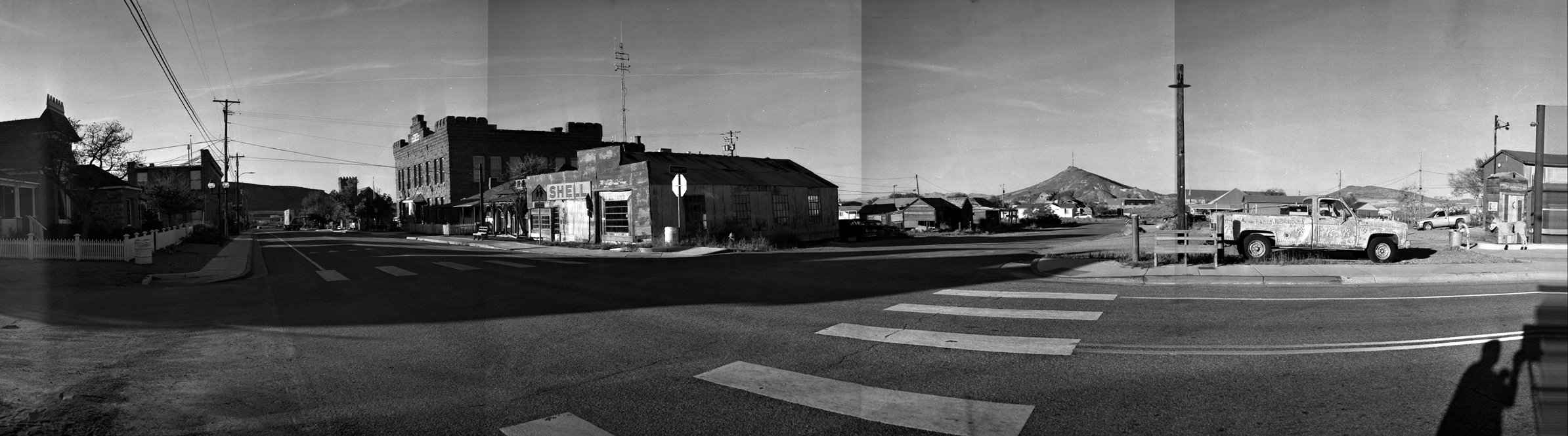

Been a while since I've posted a Cirkut picture. Please try to forgive the non stitching program stitches. I could use a simple stitching program like used to be included in photoshop before they went looney tunes with subscription. Totally imperfect, but at least I got off my butt and made a negative. This was #10 Cirkut with Aviphot Pan 200 film and I used a 12" Artar with a #58 pinion gear. It's a self portrait and you can see me waving down in the far right bottom corner.
Impressive! What is the size of the negative?
Do you know what causes uneven exposure of each frame?
Impressive! Jim don't you lure me into the World of Circuit Camera madness! :wink:
9.5X42” negative. Yes uneven scanning a piece at a time sewed together.

Thanks everyone. Hope to do some damage with the Cirkut (s) this spring. Does anyone have pinion gears that are doubles that you would sell? I know I'll have to solve the scanning / stitching situation to make these somewhat presentable. Gears Gears Gears. Need gears. Low 30's to high 60's. Can use them all.
Speechless. Another stupid question: How do you develop such a huge negative?
You got a nice tonal range out of Aviphot. What developer did you use?
I use Sandy King's Pyrocat HD developer that I mix up from scratch. One shot developer. And I load the exposed film into a 47" long piece of 3" ABS sewer pipe that has a cap on one end and a threaded adapter with plug at the other. Light tight in the pipe once the plugs are on. After the second wash (water) the lights go on. I just roll the pipe back and forth on the counter top for my agitation. No stupid questions here.
Thank you Jim. Are you camera-scanning? I have a similar problem with the unevenness but with a single medium format negative this is rarely a problem.
No I'm using an Epson V700 flatbed scanner doing about 7X9,5" at a time and then sewing all the individual scans together in one document in photoshop. The Epson is scanning darker on one side than the other.

What is the intended end-product? A contact print?

I always meant to ask; how do you store the negatives? Do you wind them up on an aerial spool?
I mean; Freestyle doesn't stock 9.5 x 42 negative sleeves...

Yes, historically a contact print was the only thing possible with these.

I roll them up and wrap a piece of printer paper around the roll with scotch tape holding the tube together and then write on the paper what it is.
