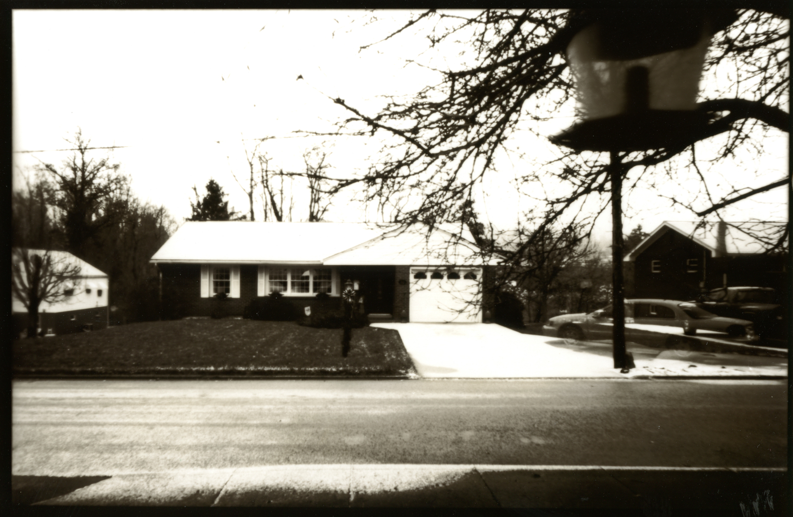

My Ilford Obscura Pinhole 4x5 is going to be delivered today but in the mean time, my shoe box keeps doing pretty well.
After my initial attempt at the pinhole I started over and tried to make one of the proper diameter and make it very clean and round. I think I did pretty well. It seems to be about .4 or so. I got my f stop worked out at f/256.
I set the camera on the rail of my front porch, it was snowing. The exposure was 28 minutes, the picture is of my neighbor's house. I got the black border by trimming the paper neg down a bit on two sides and allowing the edge to go black.
I toned it in Sepia after I was done.
I'm still amazed at what comes out of this thing.
I like how the car either arrived or left part way through your exposure. Could you please give us your impressions on the obscura once it arrives? I'd really like to see how you find it.
That's funny you should say that. My neighbor was getting ready to leave and they have a Ford truck that's usually parked there but they moved it and pulled the car you see in it's place so it's a smear of the truck and car together.
I will certainly come back and report on the Obscura.

Interesting point about the car. How long did it sit stationary to show up like that? I am assuming that in 28 minutes if it had simply arrived and then left in say 2 minutes it wouldn't show at all or be very faint but I have no real knowledge of what percentage of the total time something has to be there in a fixed spot to show up.
We now have motorways in the U.K. where traffic is virtually nose to tail for hours and moving at 60-70 mph but any one vehicle will occupy the scene for a couple of seconds only. I assume that this scenario shows as a kind of misty blur but I don't know
pentaxuser
I don't know either. I had to look out the window to see what had happened after I printed it and saw the result!
If the cars are moving, then it will be a long snake like blur I think.
That's part of the fun, this weird stuff that happens.

I've had two interesting experiences with that. One, a 14 or 15 second pinhole exposure on film looking across an expressway here that is never totally empty, and I see nothing recognizable of vehicles. The other was a pinhole exposure along a local rail trail. In the final image there was some weird, angled soft streak showing against some evenly gray pavement. Thinking back, I remembered that as I had the shutter open, a guy came by on a bicycle. I suspect it was a momentary flash of sunlight from a polished pedal crank, well above normal light intensity, but nothing else registered. Grand fun!

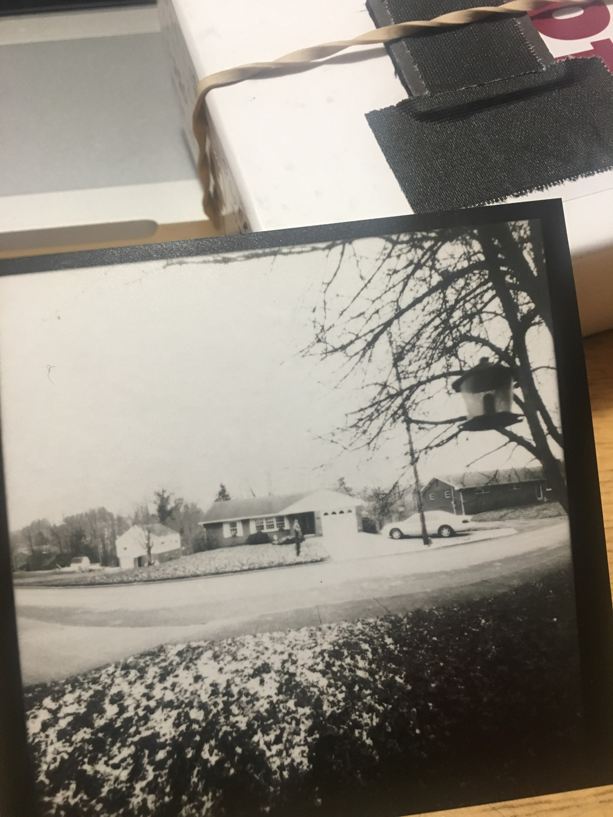

Just waiting on the Fedex guy, and while I'm waiting, I made one out of a Kentmere 30.5mm roll film box.

And one made from a Kentmere film box.
Ilford MGIV preflashed for 1.5 seconds at f/16 enlarger head all of the way up. Printed at 0 grade.
