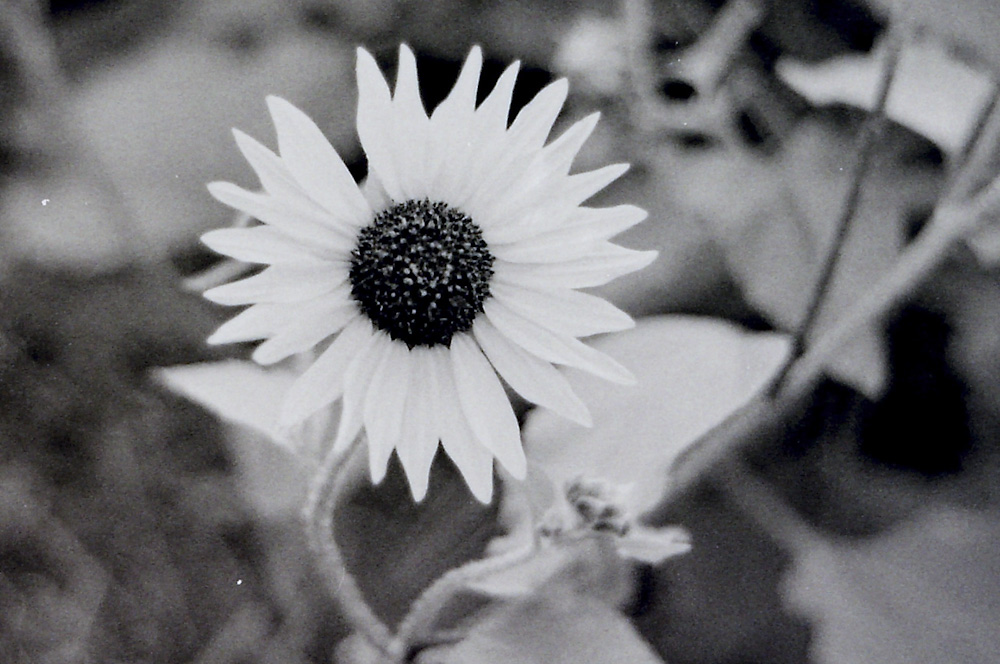

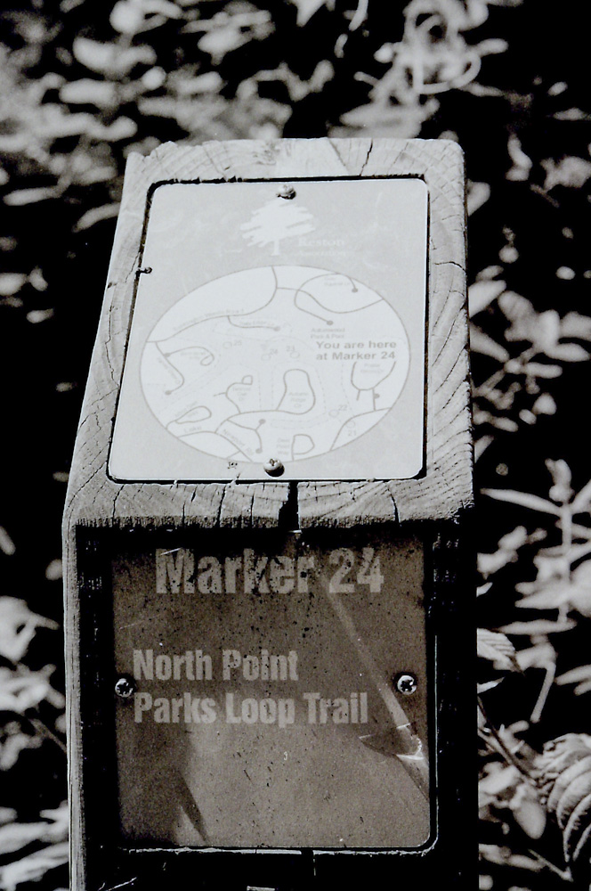

Thanks all! And congrats to Kenton on his three successful rolls! I'll scan in some images tomorrow (letting film dry well) but I should add (and if you've seen my thread under 35mm about my first roll that I got back from processing you know) my scanner is a cheap consumer model so the scans may not be that good. (looking at getting an Espon.) You know there is a certain magic in pulling the film out of the tank that just can't be duplicated by putting the card in the card reader :smile: Tnx again!

Hey! Those are pretty good for a first effort. Better than mine were, as I recall from long ago. Congratulations again. And thanks for posting.
Regarding scan quality - no worries. Believe me, everyone here is VERY good at making the mental adjustments required. We all know a scan is not a real print or a real negative or a real transparency. It's a virtual reproduction. And reproductions are never perfect. Most of us, especially those who don't bother calibrating our colorspaces and monitors because that's not why we're here or what we're after, can make the jump.
