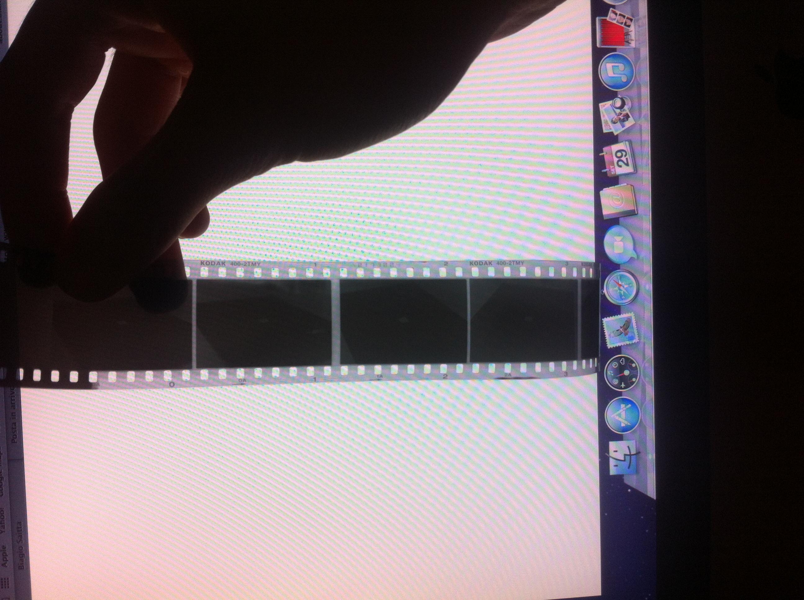

Hi!
Today I tried to take a photo of a little piece of silicon (square, side of 1.5 cm).
The piece was lying upon a white sheet of paper.
Using a tripod, ambient light and a TMAX 400@200 I metered the scene and found 1 second at f/22.
Then, I developed the film as usual using Rodinal at 1+50.
The water was hotter than 20°C/68°F, in fact was 24°C/75.2°F.
I used a generic time-temp chart and discovered that instead of 10 minutes, I had to develop for 3:30 minutes.
But, to my surprise I obtained bullet-proof negatives (picture below).
What do you think of it? It's so dense that I can't do a proper photo with my phone.
http://img264.imagevenue.com/loc355/th_020466185_foto_122_355lo.JPG
Old-N-Feeble
Feb 22, 2012
6,805
South Texas
Exposure... but they look very printable.

I don't know what % of the scene was white v little piece of silicon, but it looks to me that the white background was dominant, hence gross over exposure.

I'm voting for over-exposure because the edge markings of the film look faint to normal. With that short a time, it might be unevenly developed, too.
If you have a loupe or an enlarger, can you see detail in the frames? I can see a little, but I don't know what the whole frame should look like.

Thank you for you answers.
1) I metered using a spot meter, so I think I'll have to learn how to master it
2) I can't try to test print, for now (run out of developer); I have tried to scan the frames and didn't have much trouble although I'm quite unsatisfied.
Are you guys interested in seeing an untouched scanned frame?

Overexposed, but try printing them and see. If it is severely over-exposed (so as to be un-printable) the highlights fall up on the shoulder. In trhis case, when you print the shadows as near paper black and the highlights as near paper white, the middle tones will be too light. If you print the shadows as near black and the middle tones correctly, then there will be no whites, only gray. This is very analogous to underexposed negatives, where the shadows print gray (instead of black). However in the case of severe over-exposure, the highlights print gray (instead of white).

So:
1) How did evaluate the scene? I thought that it was a high-contrast scene (white piece of paper and relatively dark grey piece of silicon)
2) Why did I shoot 400@200? See #1.
3) How did I meter? Using the T90's spot meter. I pointed at the piece of silicon and see what did the meter say; I also thought that being grey I should place it in Zone V. BUT. I think that I clearly did something wrong, because the piece of paper is rendered as grey and not white/near white

I was taught that if there is details in the shadows, the exposure is correct and the development is off. Otherwise it's the exposure.

Presumably you have other negs on the film that were also shot at similar settings? Is it possible to show us frames that contain more than a piece of silicon? I bow to my fellow APUGers who seem to have better eyes or VDU screens than I but I can tell very little from the frames shown.

I can see a difference in density that looks like the paper, and a further difference in the centre that I assume is the silicon. If the paper was white, you would expect it to be quite dense. What colour was the surface beneath the paper? From what I can see, I am assuming that the paper did not completely fill the frame. You won't know until you print the negatives whether or not they will produce acceptable results. The fact that there is at least three distinct areas of density seen on the negative suggests that you will achieve something when you print.

So:
>>> So you overexposed one stop to compensate what reading? If you spot-read an area that should be Zone VI then +1 EV exposure is correct.

How dark is the silicon chip... Zone 0, I, II, III, or IV? If metering an area of a subject that's darker than Zone V then you should "underexpose". For Zone III that means two EV less exposure, not more. If the chip is indeed Zone V then you could have just exposed at whatever is the film's normal speed for your proceesing habits.:smile:

I inserted >>> remarks within the quote above. The bottom line is you overexposed 1 EV unnecessarily. That stated, they still look quite printable regardless of overexposure. You definitely did not overdevelop the film.

The 1-stop overexposure from shooting ISO 400 at EI 200 only makes sense to me if you intended to pull development to reduce the contrast. However according to your initial post you developed normally, so now the neg is one stop overexposed.
This was probably exacerbated by metering the "dark grey" piece of silicon. The meter will put that in Zone V but dark grey may well be Zone IV (or even III), resulting in another stop (or two) overexposure.
Fortunately 2-3 stops overexposed should print fine although with perhaps reduced contrast on the detail of the white background.

First: thank you guys for you replies.
Matt... there's no such reference to contrast range nor the Zone System nor the OP's "normal" E.I. All we really have is a decent image of the film in question and that dark spot in the middle is "probably" overexposed even for Zone V let alone if it really should be Zone IV or III.
Looking at the silicon piece, it seems a little bit darker than average grey.
So, I'm realizing that I may have overexposed about 1 stop. (Zone V instead of IV) :tongue:
