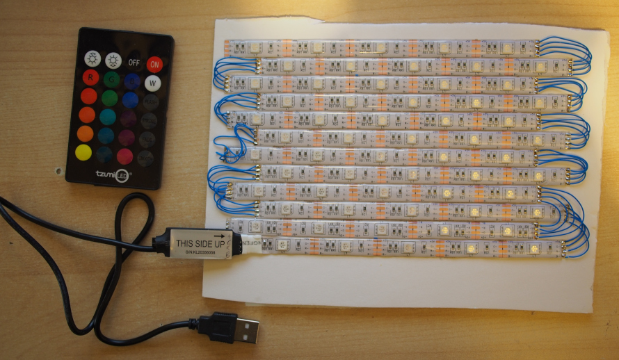

I picked up this USB powered RGB LED strip at Walmart for $10. It's 6' long with 60 LEDs. I cut it up and soldered it back together in a flat grid but for contact printing it's probably fine to just leave it as is and put it far enough away that the light hitting the paper is even.
It comes with an IR remote control with buttons to set the color and brightness. It remembers the last setting when it's turned off. So it can be turned on and off, switched between blue and green, and it will maintain the same brightness setting. It's easy to use as long as you don't hit the wrong button and make it start flashing white!

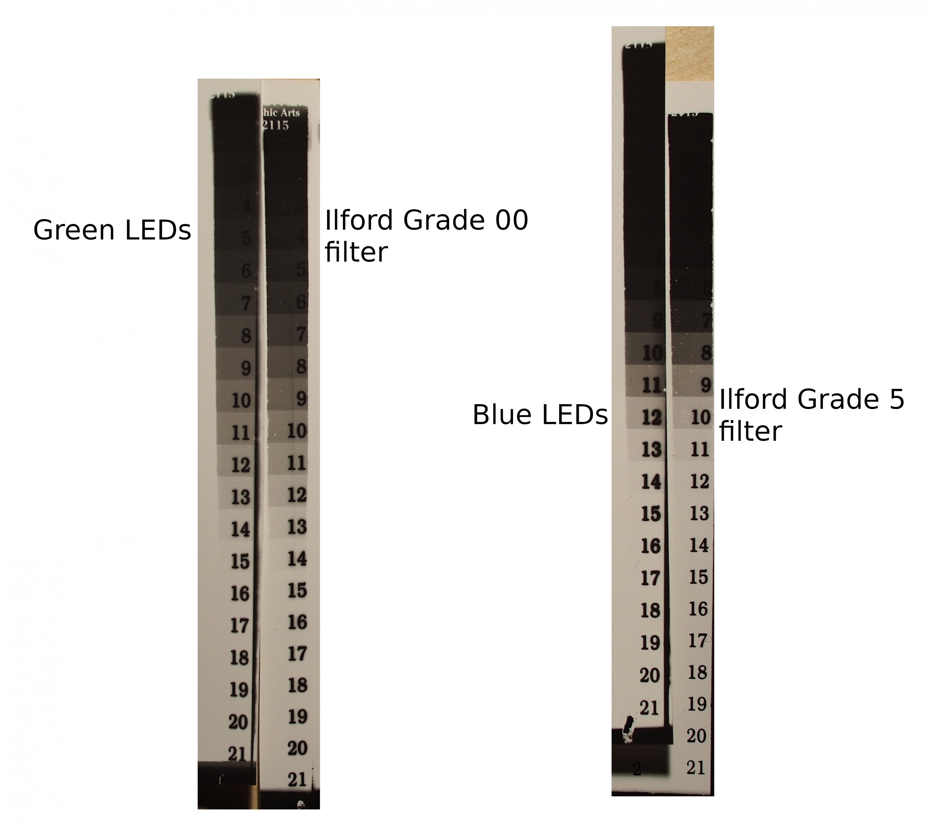

A quick test on Ilford MGIV RC paper shows the green and blue seem to work to control contrast. I compared to some old Ilford grade 00 and grade 5 filters with an incandescent bulb in an enlarger.
It also supports Bluetooth for control by a mobile app, and the protocol has been reverse engineered. So one could make a phone or PC app to control timing and contrast, maybe to make test strips automatically. Probably could even get it to work with voice control to avoid typing in numbers.

A cool idea. The test strips indicate that everything is working as intended. It's kinda hard to tell, but I'd venture to say that your green LEDs offer a softer grade (larger range) than the Ilford 00 filter. This matches my experience with green LEDs on MGRC paper.
