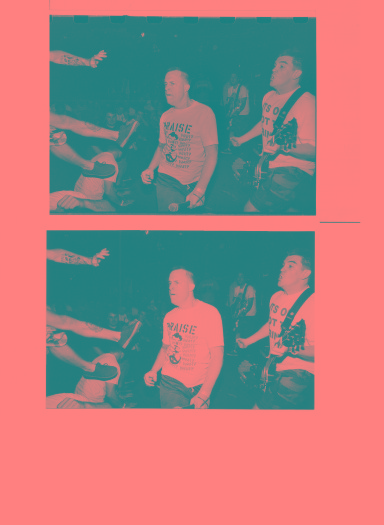

Attached is an example of my experience with xp2...
The top photo is my darkroom variation of the image, the bottom was the c41 print from a machine. I did a lot of dodging/burning on this one.
As you can see, my negs were very contrasty, xp2 in general is very contrasty if you are using a lot of flash like me...
but the good news is you can compensate for that if you print it yourself.
