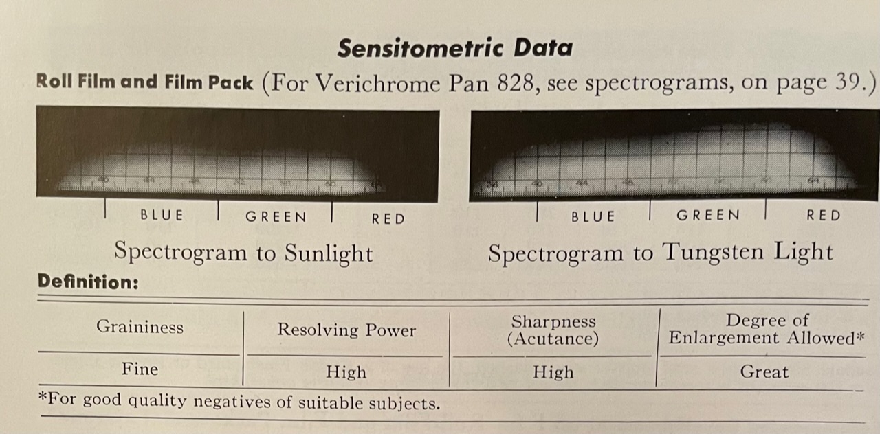

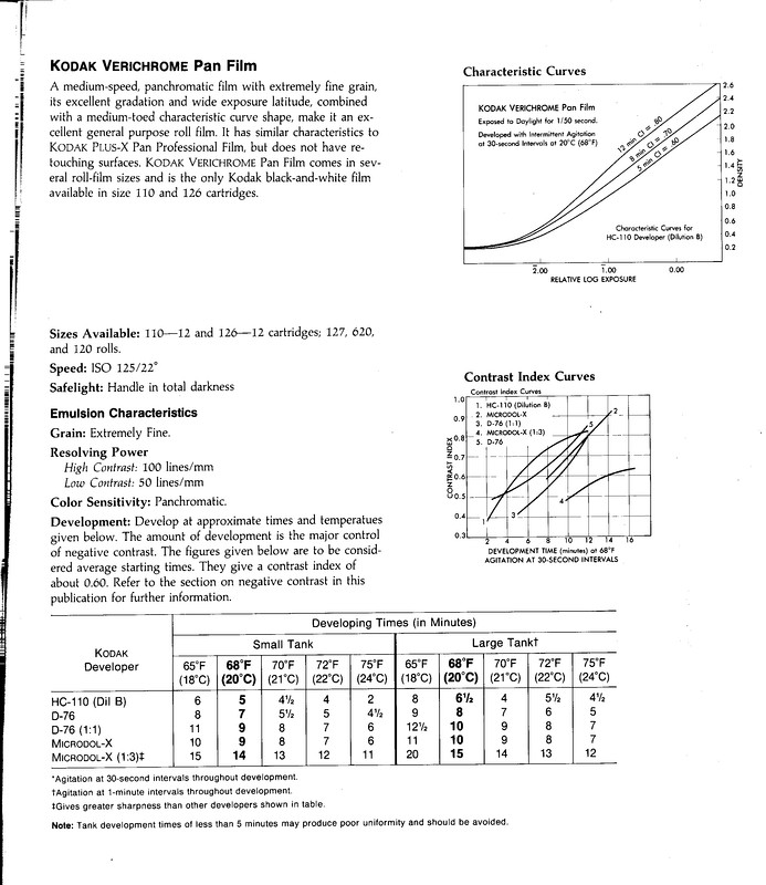

I skimmed some of my Kodak booklets and could not find any spectral response plots. Here are some curves from Kodak Professional Black-and-White Films book F-6 © 1984.
