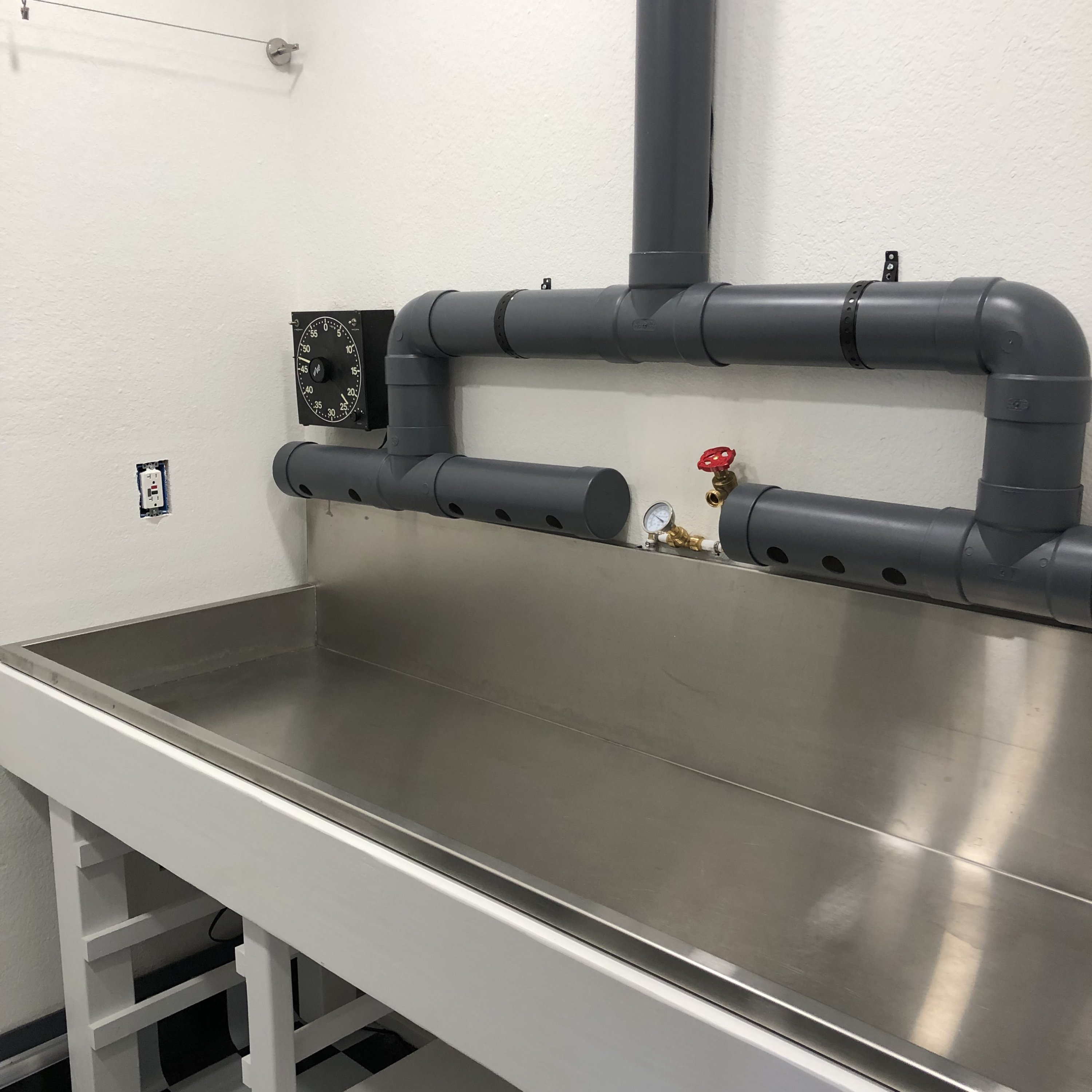

Personally, I would not work in an space without good ventilation. Why risk your health when there are so many options? I am just putting the finishing touches on my darkroom now. I put an in-line fan in my attic space and pull air out of my darkroom through a 4” PVC system. It may be overkill, but I value my brain cells
