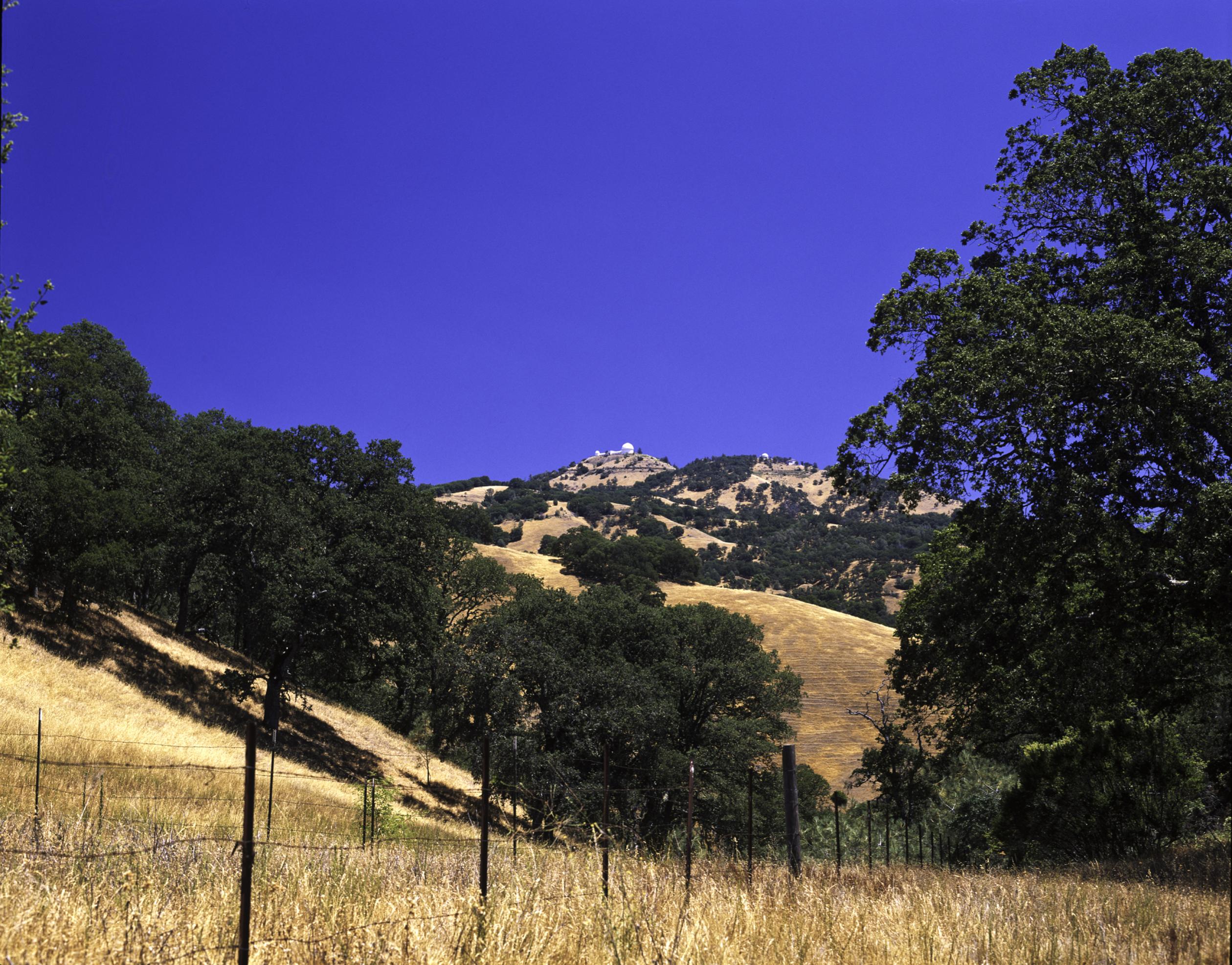

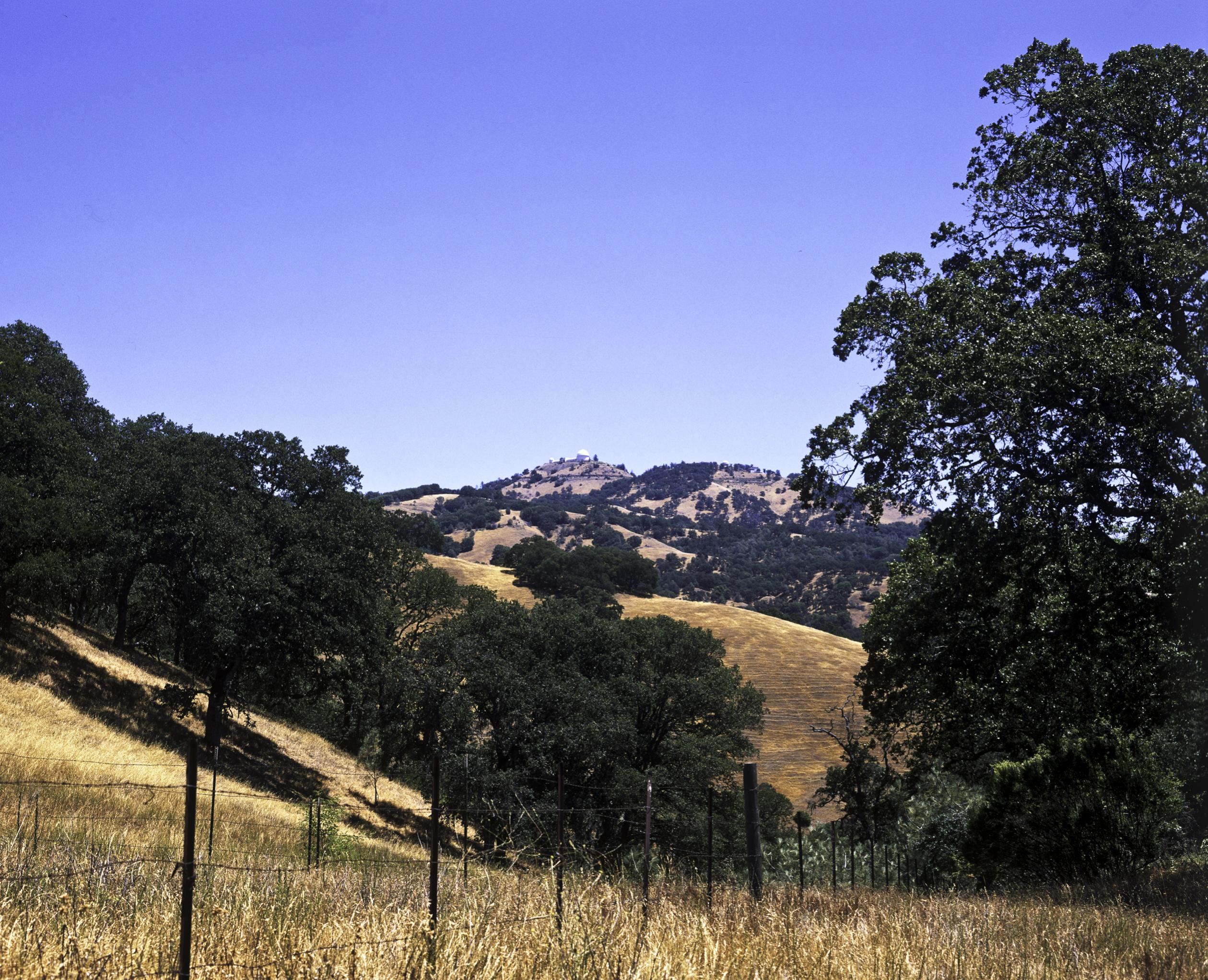

Here are shots some taken with but most not taken with polarizer. Suggestion. Don't overdo the setting when you use it. It strips the light off of vegetation making it look unreal. If you use it to saturate the colors, turn it down to leave some of the reflections to make it seem normal. Question I have for you guys, what stop increase do you use if the polarizer is at half effective vs. at full block?
Velvia 50 http://www.flickr.com/photos/alanklein2000/tags/velvia/
Velvia 100 http://www.flickr.com/photos/alanklein2000/tags/velvia100/

I use Velvia 50 in all sorts of lighting conditions. I didn't know I wasn't suppose too.
Alan, if it works for you in all conditions then not to worry I would say. Looking at your examples they are excellent !!!!
For me, the majority of my desert shooting leads me to working in softer light. The exposure latitude just isn't there with most transparencies for real highs and lows. I usually only get to work in sunrise / sunset cycles. Too much past that golden hour and things fall off for the look I like.
Good point about the sun and stops. It doesn't work for me in all conditions. I've trashed a lot of negatives. So I try to avoid putting the bright sun or sky in the frame that late in the day (or crop it out later). I aim down and use the warm low light for it's effect on the landscape rather than incorporate the sun/sky. I cheat a little by bracketing. Also, medium format gives me extra real estate to work with so I can crop. I do have Cokin graduated ND filters. But I'm not good using them. I should really practice more but the light is changing so fast at the end of the day, it seems I just don't have the time to set it up properly.
