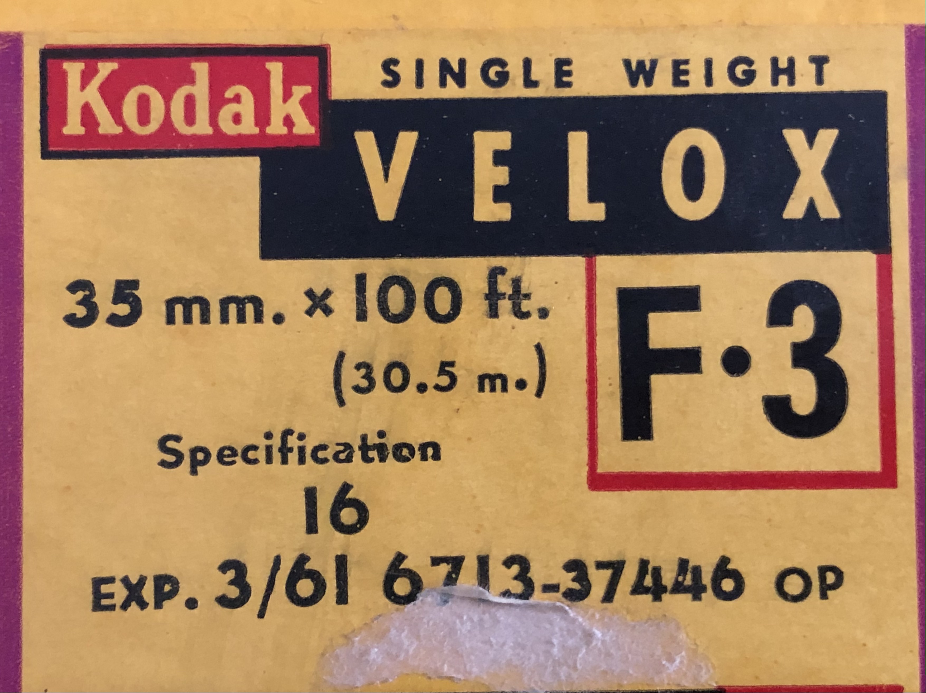

1689867874301.jpegI was given a box of photo stuff recently and this oddity was inside. Was this used in a machine to produce proofs or something else?
Photo booth paper maybe?
Velox paper was a contact-speed material similar to Azo. It came in many sizes. MattKing's idea about its use in 35mm is as good as any.

On the back of the pack of 8x10 Velox F-3 I have, it says that it's used for low contrast negatives and to process in Dektol.
I know that the F in the code is for Glossy surface finish (E would be Luster). And I believe that the following number is the actual grade of the paper. I'd have to see if I have an old book that describes the paper codes in order to get a proper description.
One thing's for sure though, by being so slow it's incredibly resistant to fog, so you don't need to use Benzo in order to get clean whites.
That's right, "F-3" means a grade 3 glossy surface. "Specification 16" refers to how the paper was packaged, perhaps on a particular spool, wound emulsion in or out, etc. Xylo is correct; it might still be usable (if you can find an application for that odd size). As for developer choice, I'd just try Dektol or any standard paper developer. Photographer's Formulary sells a paper developer that was used by Michael Smith for the similar Azo paper (both Azo and Velox are silver-chloride emulsions), but that's probably not necessary.

It's probably for contact printing 35mm negatives - maybe for passport photos or doing layouts of newspapers (the headshots that you see next to articles). Your photobooth wouldn't work for very long on 100 feet of paper. I also thought they used a faster paper, double weight, and reversal processed it. (Not sure why I think that - read it somewhere - but it might be wrong.)

When I first started in photography in 1968, I used Velox F-3 in (I think) 2.5 x 3.5-inch size to contact print the 620 roll-film negatives I developed by sluicing through 5 x7 trays of Dektol. The Velox was also processed with Dektol. With good reasonable exposures, using a contact print box, it produced good prints. In 35 mm form like this box, I expect that this was being used in an automated fashion (in some long-forgotten machine) as most people that did a contact sheet with 35 mm negatives in those days used 8 x 10 sheets of Velox.

Is this perforated? Leica made contact printers for making black and white (positive) transparencies and film strips, also for making cool Velox contact prints. These printers require perforated strips for transport in sync through the little printers. 😊
