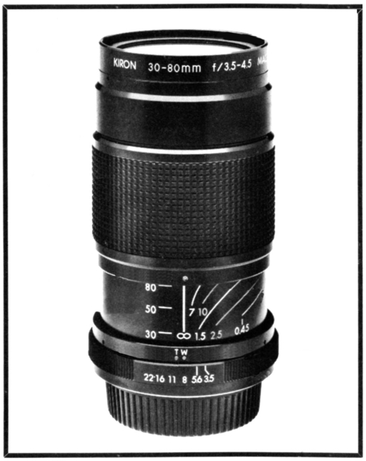

A slightly related question—it seems like a varifocal lens couldn’t have a focus scale without some way to move the scale when focusing, or am I wrong there? Has anyone made a varifocal lens with a focus scale?
You see on the Hexanon in post #7 has three focus scales. Each color-coded to the color of the focal length on the zoom ring.
However meanwhile I got a 1981 sample and I learned of another one. Both made by Kino Precision at about the same time.
Didn't your example have a focus scale similar to the Hexanon?
I got the Kiron 28-80 and it is a weirdo lens, scalewise. As between 28 and 50mm FL by focusing to nearby the universal operating ring moves outwards the same time as in zooming. The distance curves in that range are that scarce that at first sight at the scale one gets the impression that focusing implies zooming too... Looking through the finder though shows that it operates normally...
This one? The dot on the focus ring will need to follow the curve line to stay in focus as you zoom (except infinity, of course).
Yes, but you better say than do so...
The curved focusing track makes sense with theses curves, however when you start at 28mm and infinity there are no curves visible yet, and what comes is scarce and the 26cm limit is wrong/lacking.
In any case I was irritated, what never happened before on this subject.
(By the way, the front lens peak is just behind the filter thread. The lens needs a stub shade (have to make one) or an added pane or a cap.)
