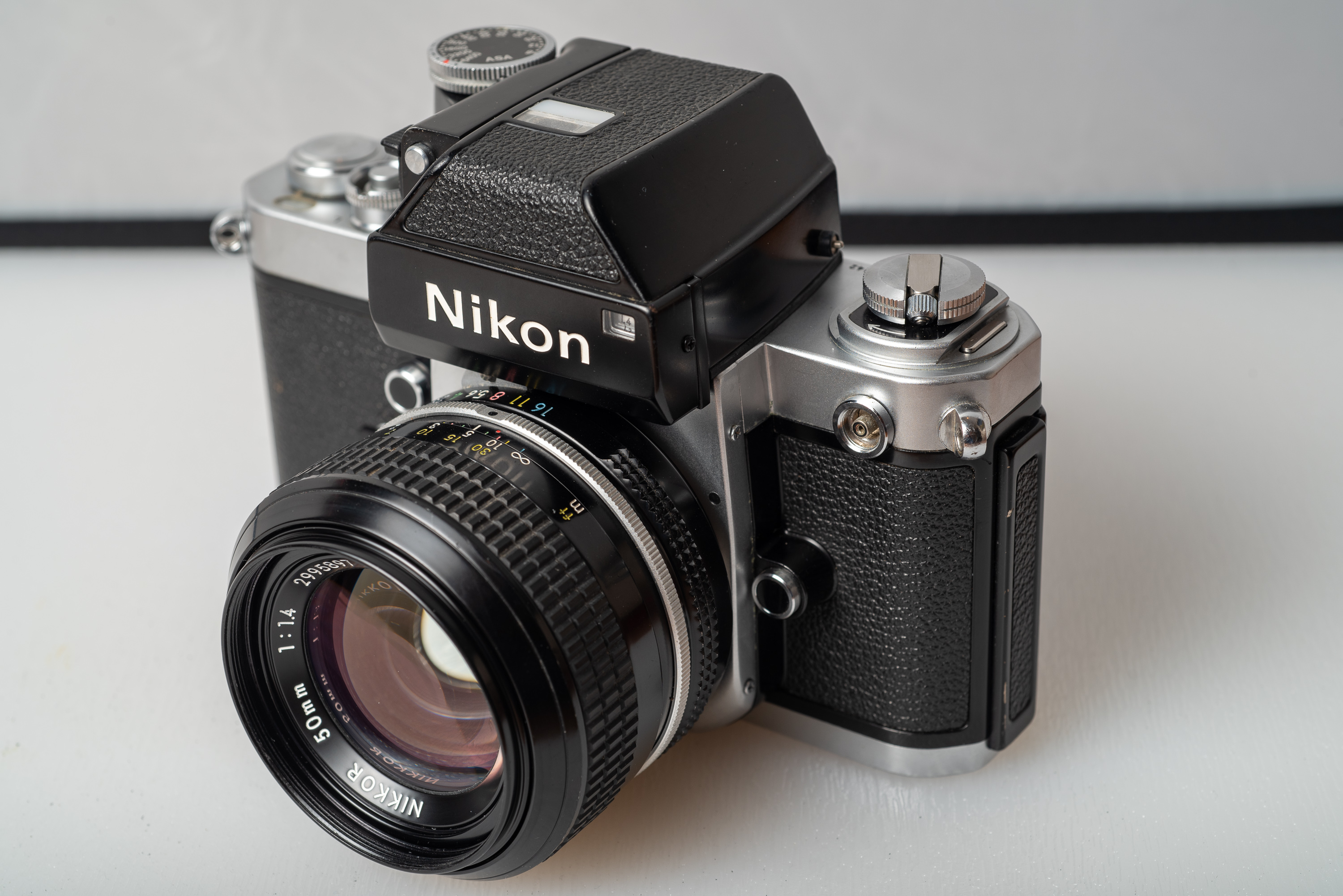

I'm super happy. The meter doesn't work and many wise folks foretold. It powers up, but testing it against 2 other known good camera meters (including one that made these pictures)... the DP-1 was saying a 1/1000 shutter at f2.8 in my kitchen when the other two read 1/8th a second (at 400 ISO).
If you want to see more pictures of my new friend there's a link here.
Thanks for the moral support and for the abundant wisdom.

I can only refer to the picture in this thread: it is super clean. As clean as if it would have left my workshop, and I am very critical on cleaniness, even when one of mine is battered.
Some q-tips were harmed in the making of this image

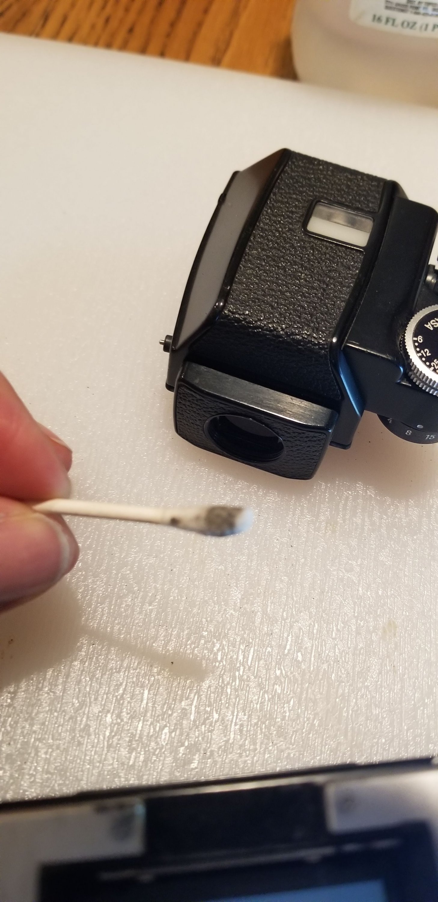

Ariston
Jan 20, 2019
1,658
Atlanta
Eric, check out the SECOND page of this thread:
https://www.photrio.com/forum/threads/dp-11-meter-issues.180501/
Since yours is responding, it is worth trying to clean that resistor ring. I think the DP-1 should be the same. It is not that hard to get to. Don't take the leatherette off; it's not necessary.
Turn the finder upside down. There are four screws holding the rubber down to remove, then four screws under that, and that's it. Take some alcohol and clean the inside of that big ring carefully, and make sure the brush is making good contact.
