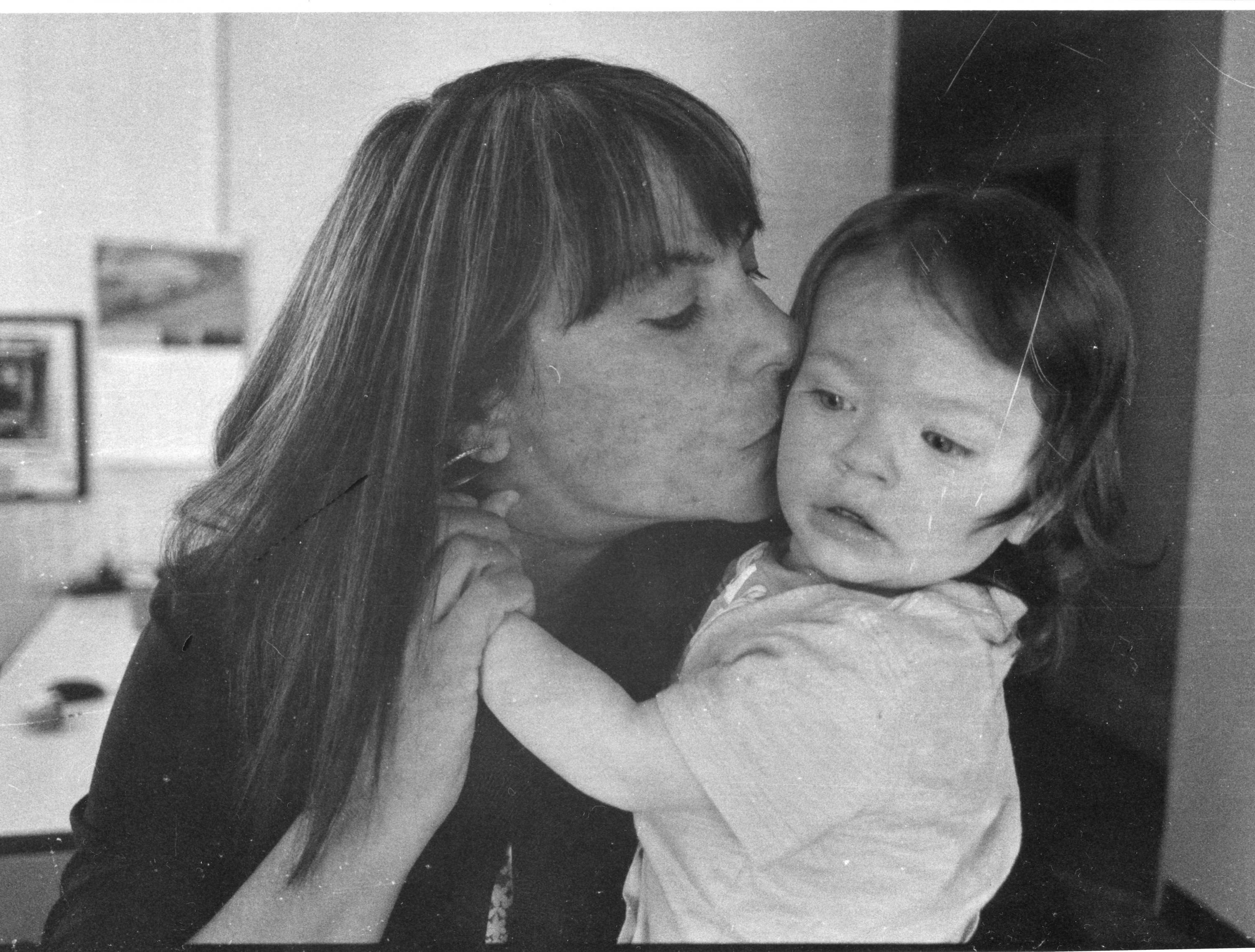

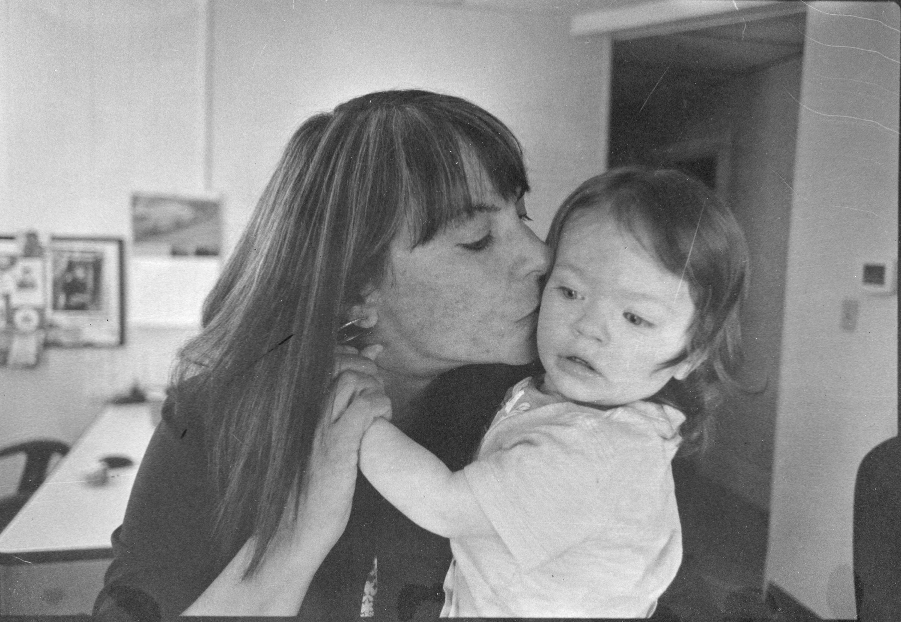

And finally here are scans. These are not final prints (I gave the finals to the woman in the picture) but they are close enough for this purpose. The contrast difference is apparent — in these samples, it is partially a difference in filtering and partially a difference in exposure. I understand that this is not exactly apples to apples but I wasn't conducting a scientific examination.
Perhaps I ought to!
Cropped one is the Componon-S on Valoy II at f16 split filtered under the lens; full frame is the V35 / Focotar 40 using color-head filtering.
Both scanned at 2400 dpi then resized to 600dpi in order to upload.
Am I imagining the difference in sharpness?
Probably.
The valoy print looks darker and more contrasty. Both of these things can make a print look sharper. The slightly smoother gradation you get from a diffusion head can also have an effect. Very hard to evaluate the lenses this way.
I don't think anyone will be able to give you accurate observations based on scans.
