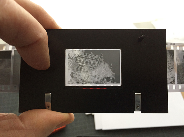

I’m using the later gray Valoy II, and having a time getting the negatives seated exactly in the open space. There is a small amount of border available, but getting it even or even close on all four sides is a hell of a task. Any tips for placing the neg in the carrier and/or holding it in place? Hard to see how it’s seated until you lower the condenser head.

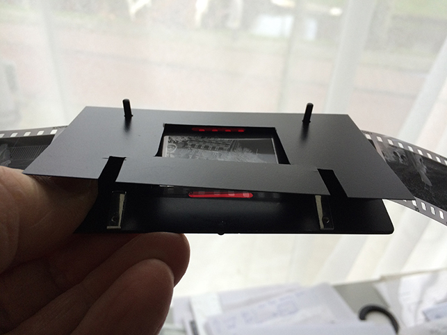

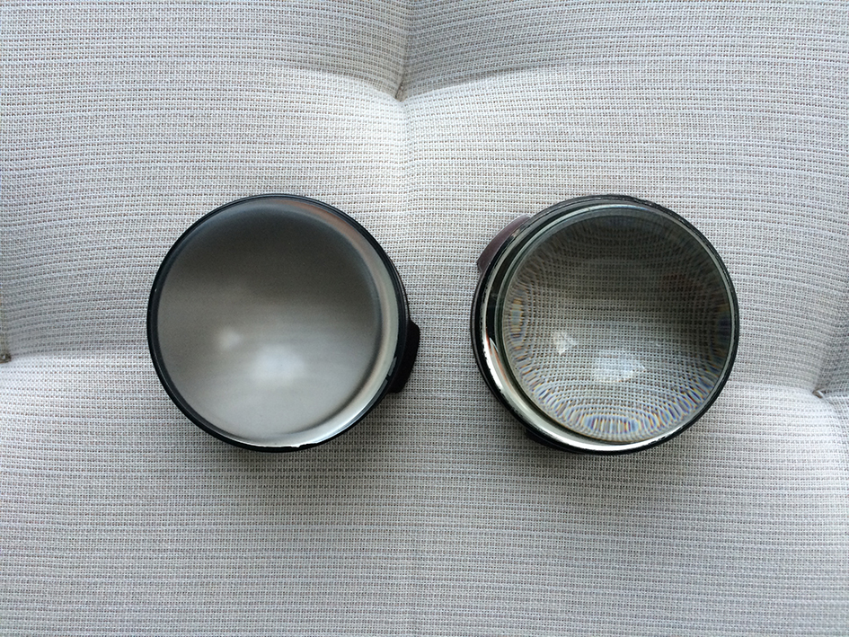

Thanks. that’s a great tip on the blades. Here’s the setup:
The Valoy II is a great enlarger and the suggestions here are all valid.
But your reality may be different: you may not have the "anti-Newton adapter" Eli speaks about. And you may not need it as your late grey Valoy II generally came with the frosted AN condenser. To check: this condenser sits in the opening locked with a bayonet. Push it up slightly, turn it a bit and it will come down. Now you will be able to see if the condenser's glass is clear, or frosted. You can now also clean it very well. Installing the condenser: just push it back in, turn it a bit and it will catch. Attached a picture of the two different condensers
About the negative carrier: most of them give a black border which is narrow, uneven and fuzzy on the outside. That's what we called the Leitz border for a long time. It can be quite beautiful, but in general I prefer to have a straight border, so I filed out a negative holder about 1 to 2 millimetres all around and mask off with the easel. Of course, using the easel, we can also chose to have no black border.
With regards to adjusting and calibrating this enlarger, just do some prints and check the grain in the corners. There generally is no problem.

Unfortunately, it appears I have the clear glass and not frosted. Is there a part code on the anti Newton ring adapter?
Leitz will have given the AN ring adapter a code name, but it is not on the piece itself. Here is a picture of it attached to the condenser, so you know what it looks like. They do not show up often.

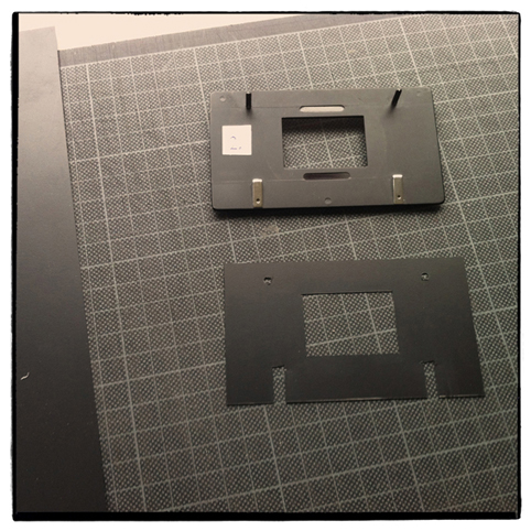

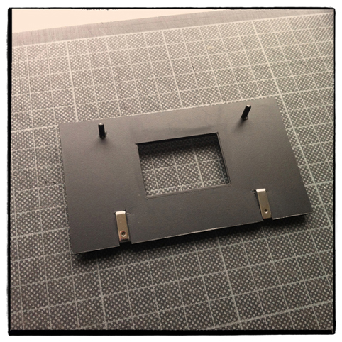

It is easy to fabricate something yourself. I used thin black pvc sheet and created a sandwich that fits on the holder. You just want to prevent the glossy side of the negative touching the glass of the condenser. See pictures . . .

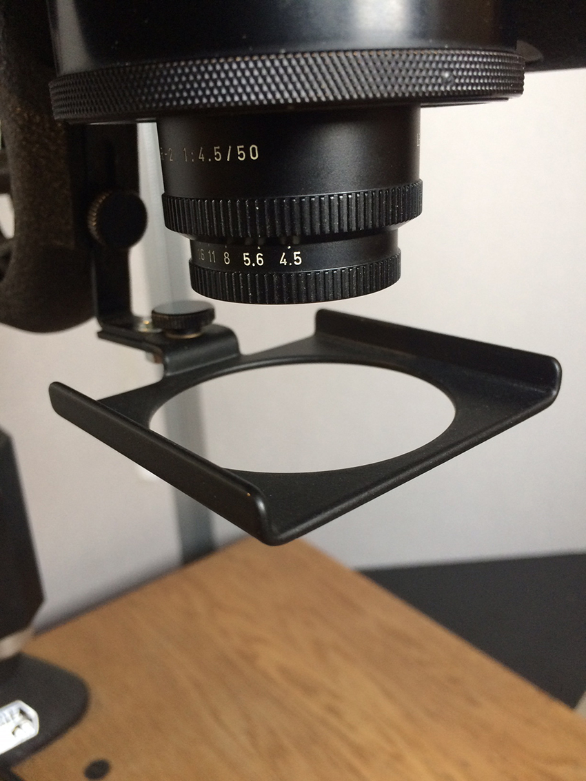

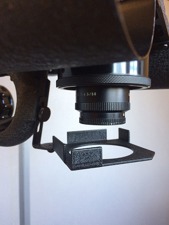

Indeed, it is that. Its bracket is brilliant, as it is adjustable in height. When one takes off the red filter and attaches a filter holder to it, you can't go wrong. Pictures attached, first the modified Omega filter holder, second the Leitz filter holder.

This filter rig is much much better than putting the filter in the lamp housing above the condenser like I do. Any special mods you had to do?
Using the contrast filters inside the lamp housing (on the condenser) works. But we also risk to bring along dust and misalignment of the light system. When doing large prints it gets more difficult to reach the lamphead and bring filters in and out.
As I never use the redfilter, I just took it off the bracket and drilled holes in the bracket and in the filter holder. To determine where the holes should be put the bracket in the middle of its 'up and down' range and make sure the hole of the holder is under the lens. I use a small iron saw to shorten the holders.
The Omega holder is my favorite because it is open at the front and its diameter is larger than most other holders. That makes using it easier than the Leitz holder. Years ago, I have also used Beseler holders with four upright flaps.
A similar modification is possible for the Focomat Ic without the filter tray. You use the shoulder screw of the redfilter. And we need to saw off a piece at the back right of the holder.
If only Leitz would simply produce these filter holders and hand them out as a service to the users of their beautiful enlargers.
