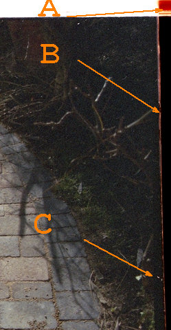

Well I'm only experienced in quantity. When set in pro mode there seems to be a problem although in full auto a bit of the shot was chopped off.
Supermarket scan heavily sharpened, 99p for 36 shots on a CD:-
http://i304.photobucket.com/albums/nn172/chakrata/Photo20_18A.jpg
V750 on full auto with some of the frame missing, but clean:-
http://i304.photobucket.com/albums/nn172/chakrata/testing016.jpg
Pro mode, nothing ticked as it comes, 2400dpi, red crap on right was on preview and final scan:-
http://i304.photobucket.com/albums/nn172/chakrata/testing019.jpg

Well thanks all for replying.......I must have scanned over 1000 negs/pos/35mm/6X4.5/6X7/bw/colour on an Epson 2480 and v750 and just scan in pro mode with thumbnail preview, use auto colour correction now again with Epson software or more correction in Photoshop and although I'm not an expert getting the best from negs esp b/w with grain, my results are quite good in my opinion.
e.g.
http://i304.photobucket.com/albums/nn172/chakrata/lolaparty3.jpg
http://i304.photobucket.com/albums/nn172/chakrata/img374.jpg
It's just all this crap has recently appeared around the neg frames that I never had before, it's not on the neg so the scanner is adding it and instead of scanning all 24 (or chosen ones) in one go after preview have now to crop each chosen one, otherwise I get a picture in print or on a computer screen like in my first post.
Here's another eg:-
http://i304.photobucket.com/albums/nn172/chakrata/t90kir80-200f4957.jpg
I was hoping someone would say "I had that problem and it was so and so" to save me from a lot of work trying to pin down the problem, and I did try the link given, using histogram and not using thumbnails etc, but the end result was similar (maybe better if I did more tests) but found it was more difficult as you can't see the neg in positive like thumbnails/zoom to decide what is worth scanning.

Well before I just selected preview scan and 24 (or whatever) thumbnails showed on the screen, I could then select "full size" (which was a bit larger than thumbnail) and crop if necessary each frame, then select scan and all the pics were automatically sent to windows viewer. Each frame was clean with no crap around them.
Now I have no choice (i.e. whether to crop or not) as every frame has to be cropped because of the crap around the frame.

Well I'm doing nothing different to what I have been doing for a year, but now I don't get a clean scanned frame as in e.g.
and
http://i304.photobucket.com/albums/nn172/chakrata/SRTrokf1-4vivmacro947.jpg
But the experts here can't see the problem as they crop each frame anyway, but I only crop by choice...so it looks like I'm forced to do it the experts way either at the scan stage or final scanned jpg in photoshop.
Any flatbed should produce a clean frame around the shot with supplied holders, but if my V750 doesn't get worse it's just a slight hassle as I'm not that a good photographer that every shot needs to be cropped for printing or for emailing etc
Btw three different makes of film tested and no difference, problem exists

Never mattered in the past how I put the 35mm neg in the holder, and just re-scanned a good 35mm strip and now crap around the frames. Also crap now around 6X6 neg :-
http://i304.photobucket.com/albums/nn172/chakrata/testing027.jpg
Also tried just one frame still a problem, and home mode same, but full auto a bit better.
The spaces between and around the negs are clean, when held up to the light and the scanner at the supermarket produced a nice CD.
Oh well, I can move the scanner to my second computer and try that or re-install the software...if I find out what was the problem will post.......Thanks all for your interest.

Problem solved and Epson need to be spanked.
Transferred to other operating system winxp and no problem, back to Vista a problem, so just a matter of finding what was different.....well if you select large thumbnail cropping area you get the problem (I must have switched it there and forgot) and I have no idea why you are given the choice between large and small as they look the same size after preview scan, except if you select large you get a lot of crap around the frame..

I had a moment, so I thought I would load some of your images and point out a few things ...
Firstly the stuff that you are seeing after the black border here is most likely the edge of the "black thing which holds the film"
its appearance here is of no consequence, but simply suggests that the software is making a mistake in judging where the edges are ... this is why many people (usually experienced people who are particular about things) don't like using the thumbnails view.
In this segment you can see both the edge of the area of film exposed by the camera (not all of it gets light on it) and also the film edge
A is an area of reflection (probably from the back of the film holder)
B is the edge of the negative
C is the edge of exposure on the film
I had said that I did not expect to see that edge B because normally it is not visible. To see it means to me the strip of film was short and did not fill the holder (which is also a mask to cover up the sprocket holes)
