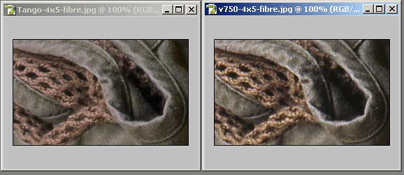

For what its worth, I was examining the tests over at Large Format Photography and was in particular re-examining some of the scans there. They are based on this 4x5 chrome:
As the scanned segments there are done at 2400dpi I thought I'd do a little surgery on the images and drop them to 1200dpi (enough for a x4 enlargement). In particular I was interested in the Tango and the V750 Pro scans .With colour matching the V750 image, sharpening it at 1.8 pixels and then dropping both images to 1200dpi I get this result
which does indeed indicate on my screen that the Tango is still ahead, this may or may not be observable on a print. Certainly for something less than competition or fine art submission should be sufficient. However when scaled back smaller (to 600dpi) its challenging to see there is any difference...
Considering that this is a segment of the overall and observing how much larger it is than the portion it represents in the overall image (sized for web) I feel this supports my suggestion that "for web sizes" you won't see any difference.

Thanks for the example pics, pellicle. To my eye the difference is just as clear in the scaled down version and I think would be even clearer if a correspondingly larger part of the image were shown (to make the final image size the same at the lower dpi).
I just see natural texture on the left and artificial blockiness on the right. I see this just as well in the "web" crop which I guess makes the point I was talking about. Maybe others don't have such "picky" eyes, however.

I have to be honest, I also see a difference in DR. Not huge and maybe prints would show less difference.

interesting ... I mainly see that the curves are different ... if that's what is being called dynamic range.

You're implying it's just a curves adjustment, and regardless, that IS indeed DR. I am not arguing with you, because I agree somewhat and have certainly appreciated your expertise and ideas, but in your last example... yes I do certainly believe that's DR. No doubt.

pellicle, I think the issue is that if you try to do a curve on the RH image to match the LH image and the shadow detail is not there then you end up with gritty horrible shadows. And that's why you crushed the shadows in the first place.
Of course it would be great to see the images as close in treatment as possible to isolate the scanner specific issues. As I understand it, this is what you were attempting. Still, call it microcontrast or call it what you will, there is a naturalness to the LH image that comes through even in the smallest size.
At some point, this is like an audiophile discussion. I remember the days of tapes and records. We were all sure we would have perfect sound if only we could get the frequency response flat and kill the wow and flutter. Along came CDs with no wow or flutter and completely flat frequency response. Nevertheless, in defiance of good sense, some sounded great and some sounded thin and bad even though they all hit the numbers.
I doubt the picture on the right can be made to look as natural as the one on the right but I sure wouldn't mind seeing someone try.
