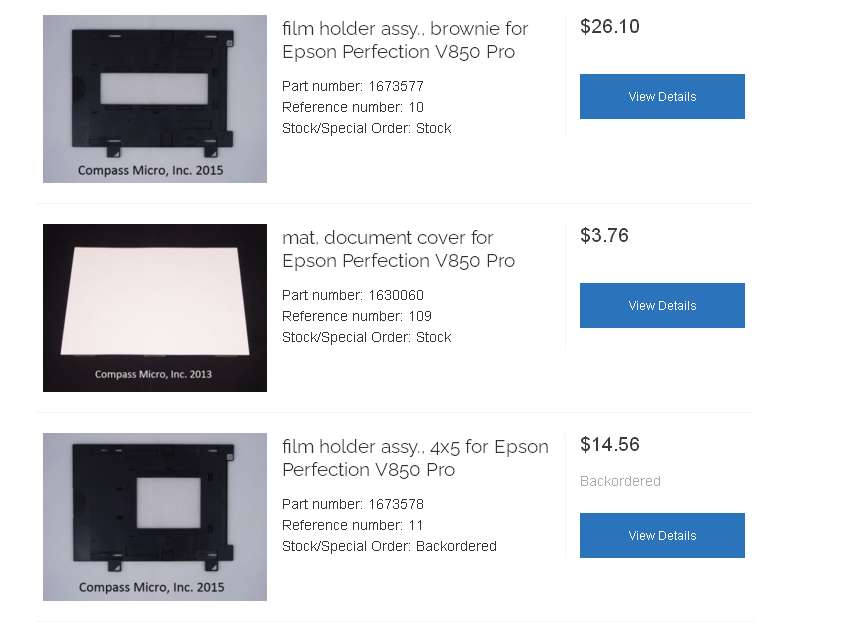

Are these ok? Will they work with the V700? I have a 4x5 for my 4990 and that seems to work but the V800 holder looks better.
https://www.ebay.com/itm/Epson-Perf...499244&hash=item2899c54c3f:g:9y4AAOSwa9xaj0wv
https://www.ebay.com/itm/Epson-Perf...062969?hash=item2898ab6bf9:g:8ZMAAOSwMYVfGdkP
Yes, this will work perfectly on your V700, but you may find it cheaper, IIRC
https://compassmicro.com/products/scanners/perfection-v850-pro.html
https://epson.com/Support/wa00399

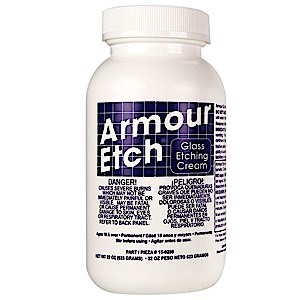

I would think PROPER ANR inserts can be cut to size and retrofitted in those same holders just to see if that makes a difference.
Yes, http://scan-tech.net/ , also sold at the bay
and you also can make your own DIY.

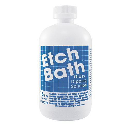

Or use the (less popular) Etch Bath variant, also diluted:
Protect one side of the glass with adhesive film. Dilute the etcher cream in water to decrease its strength and test different dilutions/times. Use a suitable flatness certified glass, like those used to make mirrors. Some kind of glasses may be more suitable, but I made ANR glass for an enlarger glass carrier and it worked perfect.

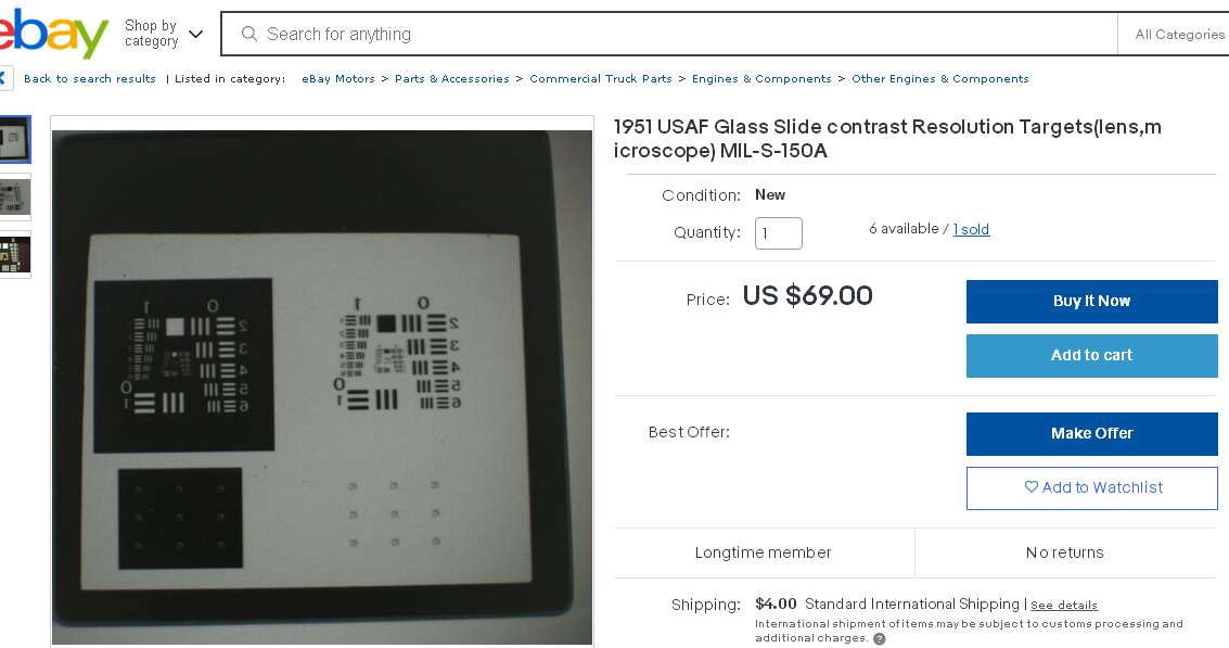

So I need to dig out the best negative I've got, and redo the tests.
You may get a glass slide to make the tests in a quantitative way, you may make an offer for the half and see:
The slide measures 63mm, to fit in the 120 holder you may have to grind one side, while protecting the rest. My slide was grided in a shop selling eyeglasses.
To adjust the 35mm and 4x5" holder I made a contact copy on CMS 20, I've a box of CMS 4x5...
grat
May 8, 2020
2,044
Gainesville, FL
I realize everyone considers the 1951 USAF High Resolution Target to be the gold standard for determining the resolution of a scanner, but I'm just not sold on it. The idea of the original target was to take an image of it, typically with a film camera, and then analyze the resulting image to determine (usually via a microscope and a good eye) the maximum detail that could be clearly resolved, and then, use that to look up the effective resolving power.
The modern version is to scan the glass slide (so now you've got light passing through three refractive layers, two of which have one refractive index, one of which has another), convert those light levels into a digital image, using a sensor that uses a grid of Green, Red and Blue photo-sensors that then construct a single pixel using those 4 colors, process that image and then, view it on another digital display device (which is designed to translate a digital image into an analog image), and THEN then end user does an analog evaluation of the result using the Mark I Eyeball. There's a great deal of opportunity for data to be altered in that pipeline.
And that's assuming you achieved critical focus, which on the Epson is entirely guesswork.
Now-- it *is* a very sharp object to do scanning against, so for determining critical focus it's good, but it's overpriced for that functionality.

I realize everyone considers the 1951 USAF High Resolution Target to be the gold standard for determining the resolution of a scanner, but I'm just not sold on it. .
It is only black and white lines, transparent and opaque, of known widths. The question is what you do with it....
got light passing through three refractive layers, two of which have one refractive index, one of which has another),.
You scan the patern that's under the glass slide so that glass has no impact, as the image is taken after the rays have passed the glass
You know, that was *exactly* the same argument I made for why the ANR glass shouldn't matter.
But it apparently does.
