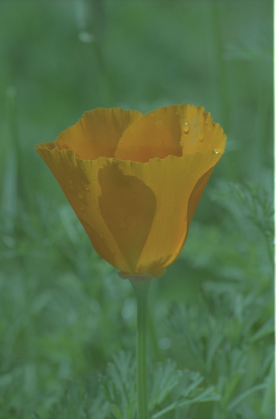

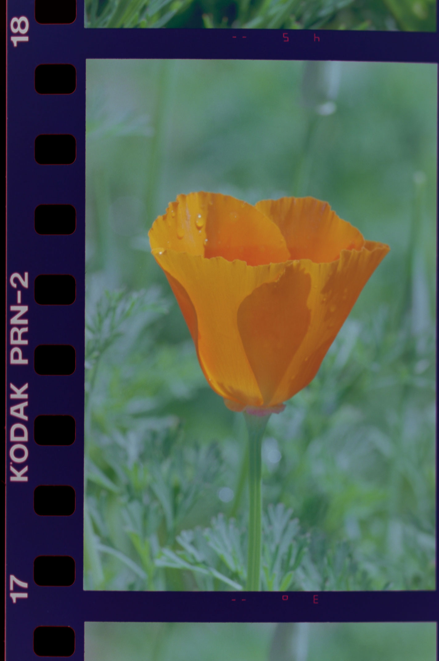

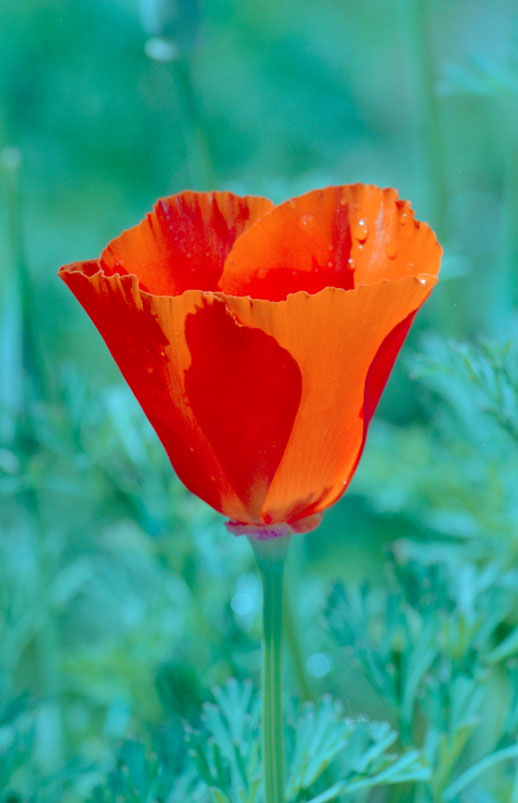

I keep reading these posts but there is no qualification to the comments.
My eye is calibrated to Gallery Quality Print be it traditional it inkjet.
In post 9 of https://www.photrio.com/forum/threads/flatbed-film-scan-greater-resolution.162327/ is some useful information on scanner resolution.
3rd party testers use a USAF 1951 test target for the scanner resolution. Its fine for testing film and lens resolution as designed but does not provide a true picture of a scanners ability. The ISO 12233 https://www.graphics.cornell.edu/~westin/misc/ISO_12233-reschart.pdf is much better.
Due to the sites limitation a full res scan cannot be posted. Full resolution scans must be downsized to post inline. I have a V500 and Plustek 7600i. The only difference between the V500 and V600 is the transparency area.
Silverfast Ai6 will not run on Windows 10.
Top left: V500 @ 6400dpi, 48 bit RGB, Vuescan, color set for the film type.
Top right: V500 @ 6400 dpi, 48 bit RGB Epson Scan with No Color Correction selected.
Bottom Left Plustek 7600i @ 7200dpi, 48 bit RGB, Vuescan with color set to the film type.
Bottom Left: V500 vuescan scan color adjusted in PS.
Film: Kodak Pro 100 (PRN).
DPI set to manufacturer stated optical limit.
Gallery quality, maybe. Proof quality for a magazine editor/gallery curator, definitely.
Good scanning takes practice. Scan for the best detail from the negative, adjust the scan for best image in post software.
The negative on a Logan light box with a Nikon D300 , 60mm f2.8 Micro Nikkor hand held.
Les Sarile
Aug 7, 2010
3,425
Santa Cruz, CA
Personally, I don't find sharpness and resolution as important as color fidelity. Here are a couple of examples of color failures I've encountered that would make you think they were from different frames of film when in fact they are the same one.
Re: Coolscan 5000 versus Epson V700. You do not state what software was used respectively for these two scans. The color balance depends more on the software+procedure: auto-colors? auto-contrast? fix and freeze gray point on gray card frame? profiled?... than on the harware model that you use to label the images.
But I'm sure you know that quite well.
bernard_L
Feb 17, 2008
2,027
More interesting would be both scanners with, say... vuescan, and same settings. There is a difference, but much less. In my limited experience (slides) the colors are more saturated with coolscan, possibly because the RGB LED's (Coolscan) have narrower spectra than the response of the EPSON RGB matrix sensor, and presumably less sensitive to dye cross-talk.
