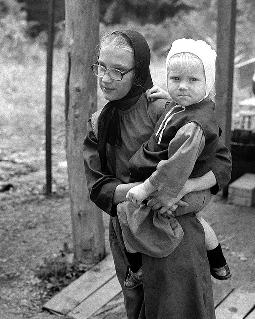

It could be I'm not setting something right but I've tried going back to a B/W setting just to be able to frame each negative but then it all turns white and nothing there. There is obviously a learning curve to VueScan. Today I scanned some more old Agfapan 400 negatives of a Mennonite community about 30+ years back and got some decent results with the Epson software although it took a bit of tweaking with my PP software.
scan0006a by David Fincher, on Flickr

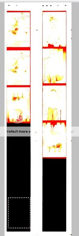

This is what I'm seeing when I use VueScan. I have to use color for B&W negatives so they'll open in my PP software. The scan looks good but orange but once the scan completes it looks like this.
OK-I think I found the answer to that problem. After looking over the Input/Output and Color tabs I saw nothing wrong. I decided to open the Image file and then clicked on the "Graph B/W" moved the slider over a little and voila, a dark B&W image emerged and gave me the chance to crop and scan to my software where I made the appropriate changes.
Comparing two like images in both the Epson and VueScan software it was obvious I had better results with the VueScan. Things seems to be moving along a little better. It may behoove me to get that copy of "The VueScan Bible" if I intend on keeping it.
