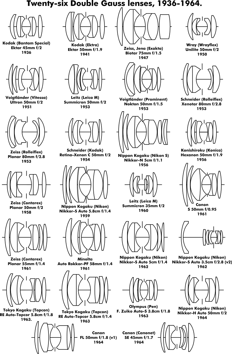

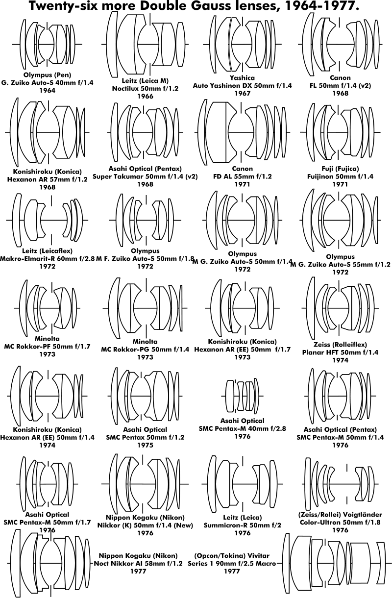

I was recently given a pretty clean UV Topcor 28mm f/4 to use on an old, but fully-operational Topcon Unirex that I picked up several years ago in Japan. I understand this may not be a great lens, but I researched around to discover that this 28mm has 6 elements, but I'm curious, would anyone know the exact lens layout design? Double-Gauss, right? I found some diagrams with many brand name double-gauss designs, and Topcor is there, but totally different apertures.
Any ideas?

If you notice, the double Gauss lenses are 'normal' FL.
The 28mm FL for the Topcon Auto 100, UNI, etc. had to be a 'retrofocus' design in order to allow space in the body for the reflex mirror to flip up!
