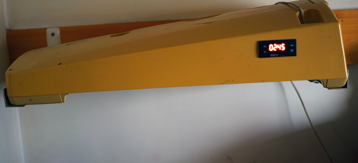

My tanning lamp is a 310 W Phillips tanning lamp with 8 tubes. The tubes are ~57cm long (~57X38cm is the active surface of the lamp) and, wall-mounted at ~ 50-60 cm from the paper surface, it gives me times of ~ 2-5 min with PT/PB, VDB and Gum while covering more than 20x20 inch.

Mine looks like this:
The digital timer is mounted by me.
