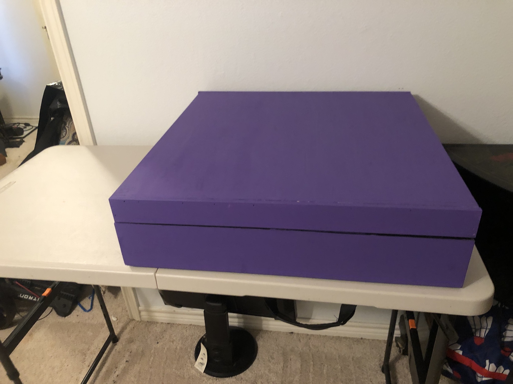

The UV box is built!i
Id post a pic.. but it’s well… like my photos , not exactly professional… haha.
Functional. I may need another oh two maybe three strips. 24x24 takes a lot of them!
I kinda ran out..
It’s ok, I accept my fate lol.
Dang thing pulls 10A at 12v. Luckily I have a honker 30a supply for ham radio!
Yeah it’s almost 2am, dang leg cramp
Looks like about 4 minutes exposure time for a nice blue. I actually removed a few strips.
As expected some of the strips (eventuality probably all) started coming loose from the painted and sanded wood surface. Re-did those with contact cement. I think that will hold up for a while. That also gave me
the opportunity to re-align and re-space some of the strips.
it may be a mother loves it ugly, though it is colorful. I may just paint on some racing stripes or something..
front door is held on by two Magnets.... I need to add a third at top middle.
"Purple mountain haze majesty"
26 strips, smd5050. Six inches high. I will experiment a bit with height, by adding wood blocks underneath. Bought some 1x1 basswood for that.
