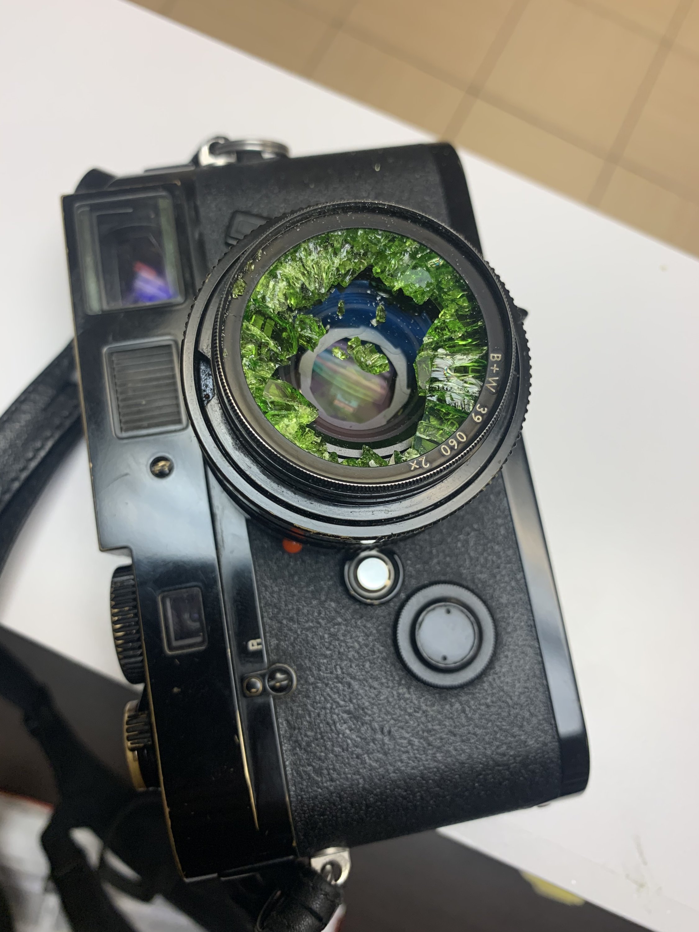

My experience is the UV filter breaks and scratches the lens. I use the lens hood and keep lens cap on when not taking a photo. Lens cap is best protection.

I have never, in over 58 years broken a filter of any type when fitted on the lens. I have however had to discard filters that became scratched after several years use, but the front element underneath was like new.

The UV filter doesn't protect the lens from impact or fall but it does protect it from dust and dirt and fingerprints; well worth it to me.
You haven't lived until you smash a lens into a rock -- or a rock smashes into your lens -- and your blood drains to your shoes. Then you examine the damage and realize, "The only thing broken is the UV filter!".
That's happened to me TWICE. The first time convinced me to always put a UV filter on the lens. There are a few times when I remove it -- briefly -- for example, when I am using multiple filters or want to avoid vignetting on wide lenses, etc.
I have had it bang rocks and bend the rim of the filter instead of the rim of the lens.
