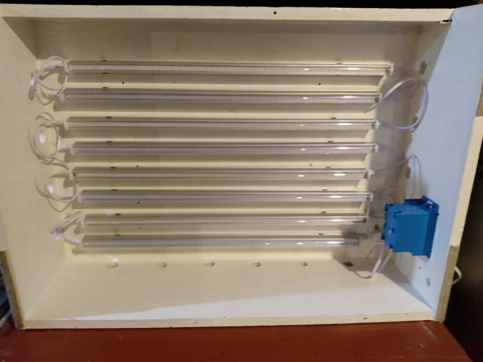

Brian,
Now that I have 8 strips, they are on 2 inch centers. I added the second set between the original strips which were thus on 4 inch centers.
The inside of top of my box sits 8 inches off the table. Give roughly an inch for the LED strips and an inch for the print frame. Thus the glass of the print frame is roughly 6 inches from the glass of the print frame.
The box is painted a glossy white.
Here is a photo of the inside of my box:
The blue electrical box is left over from when I had fluorscent bulbs installed and is not necessary with LEDs. Also, I don't think that the circular vent holes I have are needed with the LEDs as they run much cooler than the fluorescent bulbs. However, I have not tested this.
The light is very even. I do not trouble with uneven exposure. I generally print in an 8x10 frame; often two under the UV at the same time. The largest I have printed is an 11x14 image in a 16x20 frame.

I have been very happy with my retrofit. I was having trouble with balky fluorescent bulbs (remember the original post in this thread!) that were at least a decade old when I decided to retrofit with LEDs rather than replace the bulbs. I have zero regrets with this decision.
