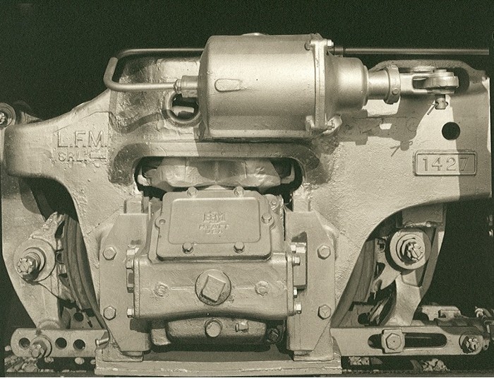

I aquired a used 400w HID and have spectacular results with it. Unless you're printing 16 hrs. a day the increase in your bill isn't really that bad. I love how it works and would really urge you to keep an eye out for a used one. A bulb can be had for about 30 bucks and will last quite awhile. I don't make my negs to thick and find my exposures are around 2-5 minutes normally and if the neg is bulletproof they will go to around 15-20 minutes. Attached is an image with 2:00 under a 400 watt HID.

Yeah, yeah, yeah...quit showing off Mike.. :smile:

You're killing me Jorge! One of the reasons I responded to this thread is that I have what seems to be really short print times. I hear allot longer times than what I do and don't know if it's the light or my negs or whatever.

Are you using a staining developer? I use a 400w HID as well and my times are around an hour for ABC developed negs, and not the bullet proof ones either.
