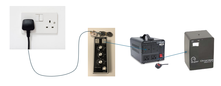

Hello all
By way of reintroduction, I am a (young-ish) film photographer based in Kent in the UK. I am about to move into my first house with my Wife, and i am currently collecting all the last bits of equipment that I need to build a permanent darkroom. I have three enlargers, my main one being an Omega D2. It came with a very old Chromega with all of power cables cut off, so I was not able to use it. I mainly do B & W but I also wish to start colour printing at some stage as I have all of the gear to do so.
I have been using the D2 with the intrepid LED light source which works, as it sits on top of the negative carrier, but it is irritating as it moves around. I have thought about 3D printing a harness/cage for it but I just want to concerntrate on getting better as a printer.
I was scrolling ebay whilst bored at work and came across a Super Chromega (diocrhoic) version, which comes with the stabilser and accompanying power supply/transformer, all of which cost £40 excluding shipping. It was a gift from the gods, as these things are rather rare in the UK. The link can be found here: https://www.ebay.co.uk/itm/266726786316.
Looking at the photos on the listing, the plug which would power the entire thing appears to be an old US standard plug which was phased out in the early 70s. I had the idea of purchasing this (a UK to US) transformer from ebay: https://www.ebay.co.uk/itm/266718373503
In terms of the overall set up, the transformer would sit between the timer (with a UK standard plug - which I am yet to purchase, any reccomendations?) and the old US plug.
However, I realise that it may just be easier to get the plug rewired by a professional electrician to a UK plug as the power supply would regualate the power.
I am aware that i can also purchase a chromegatrol (what an awful word) from KHB but I would prefer to purchase this timer which I am about to purchase: https://www.ebay.co.uk/itm/305411448231.
I am unsure of how to proceed as I am still getting my head around how the overall Omega D2/Omega Super Chromega set up works and would very much welcome a nudge in the correct direction.

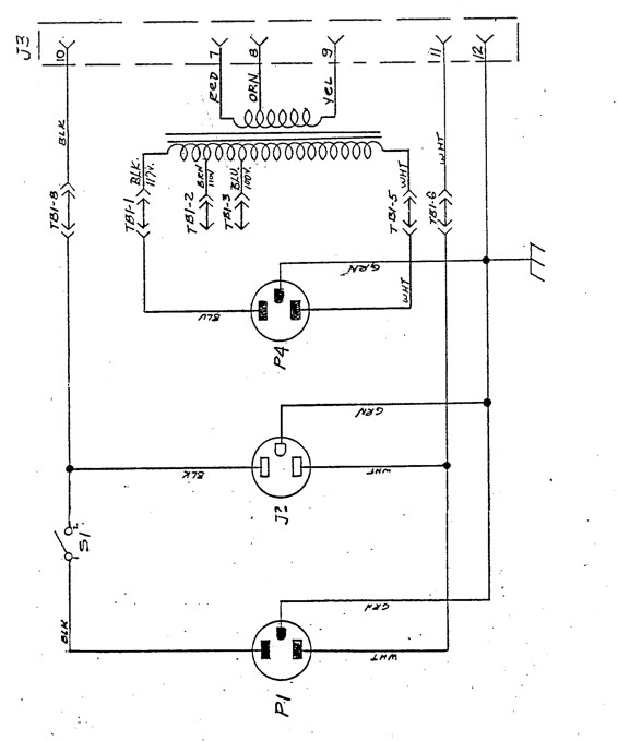

The 'usual' USA version of the Chromega power supply does have three different adjustable primary taps on the the transformer. However they are only for 100V, 110V and 117V. No 220V (see below).
I'd just keep searchig until a 220V version comes available. In the mean time maybe repair the old Chromega if it still has its filters intact. Nothing fancy there, just a standar bulb.

Any advice would be much appreciated, I am wary that I am going to blow myself up!
Nah, worst case you'll blow up the enlarger and burn down the house. Just put on your running shoes before you start.
All joking aside - it should work if you connect the 230-110V transformer to the timer and the enlarger to the transformer. The timer itself goes into your 230V wall outlet.
With a little bit of luck, the timer won't mind the transformer's inrush current. There's not all that much you can do about anyway, and it's not really a safety risk.
Ibanez
Jan 28, 2020
23
Mordor
Love the diargram!! Looks like I need to buy a further lead which goes from the transformer to the timer which won't be too hard to find. Thanks again for the advice, very much appreciated.

You should be able to find such a cable, yes. It's a bit of an oddball because it'll be a male-male cable and in the power world, something like that isn't common for safety reasons (c.f. poka-yoke https://en.wikipedia.org/wiki/Poka-yoke). Technically, a cable like that would allow you to connect one wall socket to another, which evidently is not a great idea. The reason for the exception in your case is that the transformer you bought can go either way (a convenient characteristic of transformers): up from 110 to 230 or down from 230 to 110. I guess this is why they only put female connectors on it.

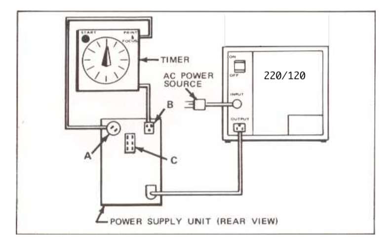

Make sure you hook it up correctly as shown in your owner's manual. Probably won't blow up, but it won't work if not connected correctly. Here is a diagram if you have the Chromega D power supply shown in the schematic above in post #6.
Thanks yes I am familiar with this diagram from the Jollinger website. I wonder if I need a new timer to complete the circuit...
You would need a 110/120v timer to hook it up the way it was intended.
The original Omega timer is nice. It actually bolts to the top of the power supply to make a single unit.

Thanks all, the transformer arrived and the fan in the head fired up! I need to rewire a c14 to a normal U.K. 3 pin wall plug (to go from the timer back into the transformer) and then test the bulb. Will report back.
If the bulb works I will then see if I can get a proper omega timer as suggested by IC-Racer.

As you work through this, that schematic above might need clarification, if you have not figured it out already. The timer plugs into the main power via the socket at the bottom of the diagram. From there, the switch controls power to the timer, which plugs into the middle socket. That way, the timer is not always connected to the main power, you can turn it off with that switch on the power supply.
Lastly, to get power to the main lamp, the timer has to output 120v to the third socket, the uppermost one.
Many thanks for the above, sourcing an appropriate timer from the US/looking into a suitable converter plug is my next step.
