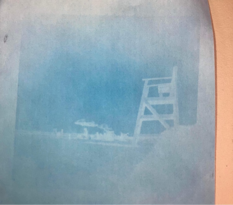

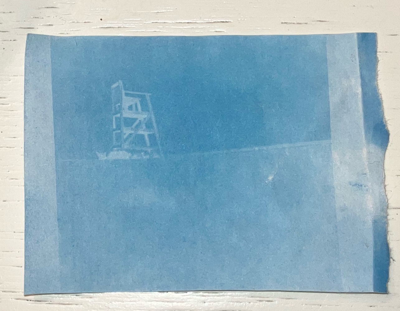

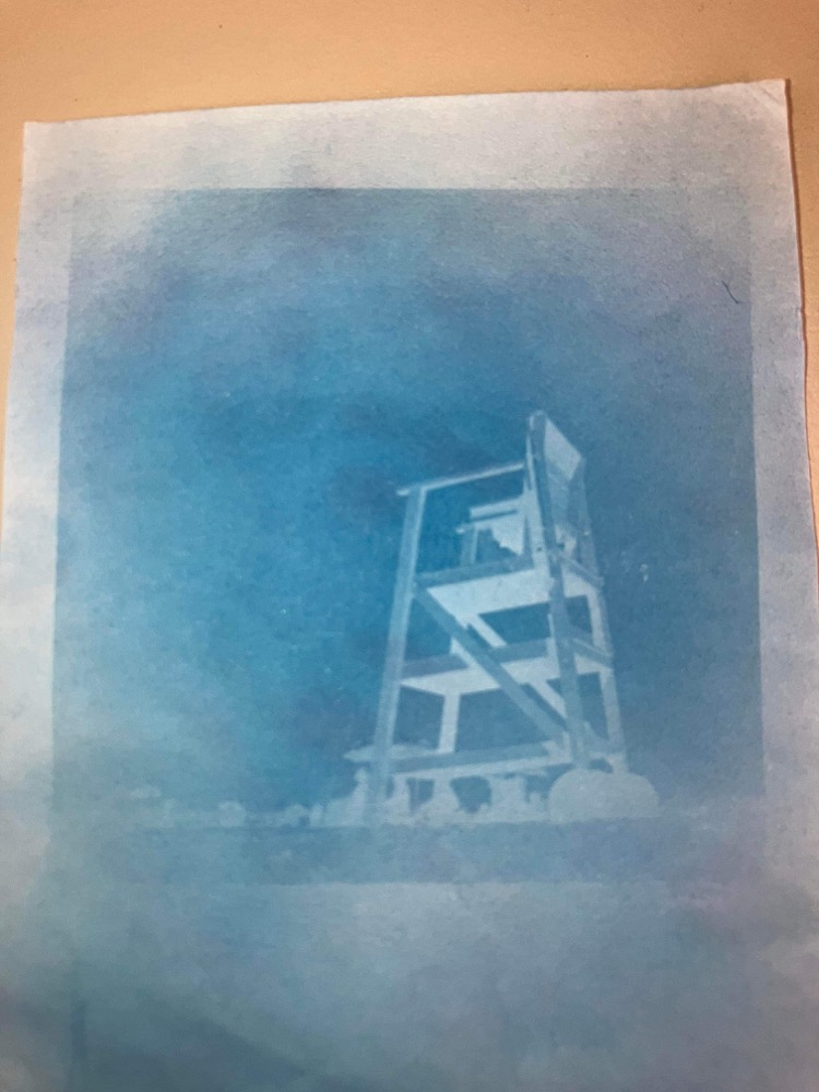

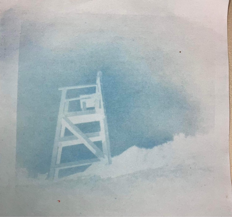

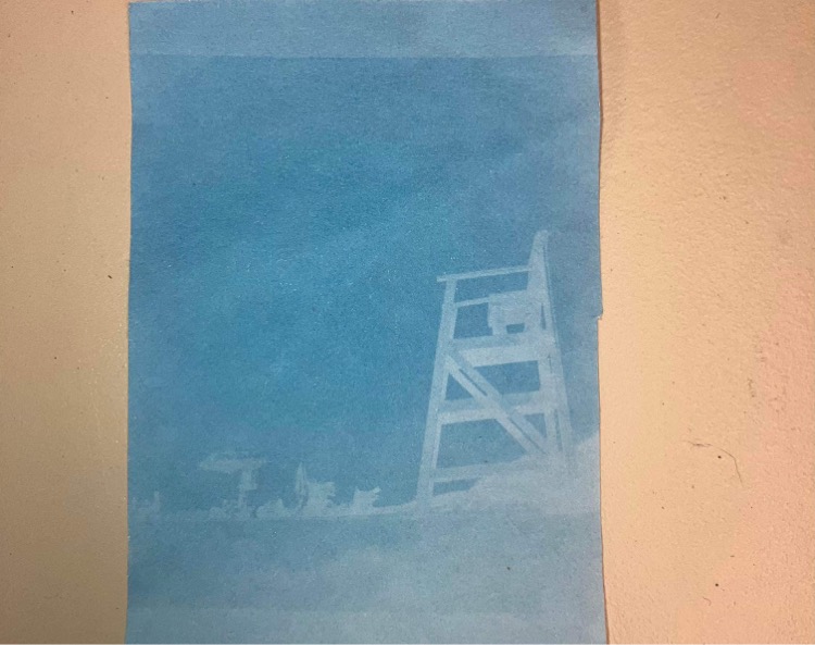

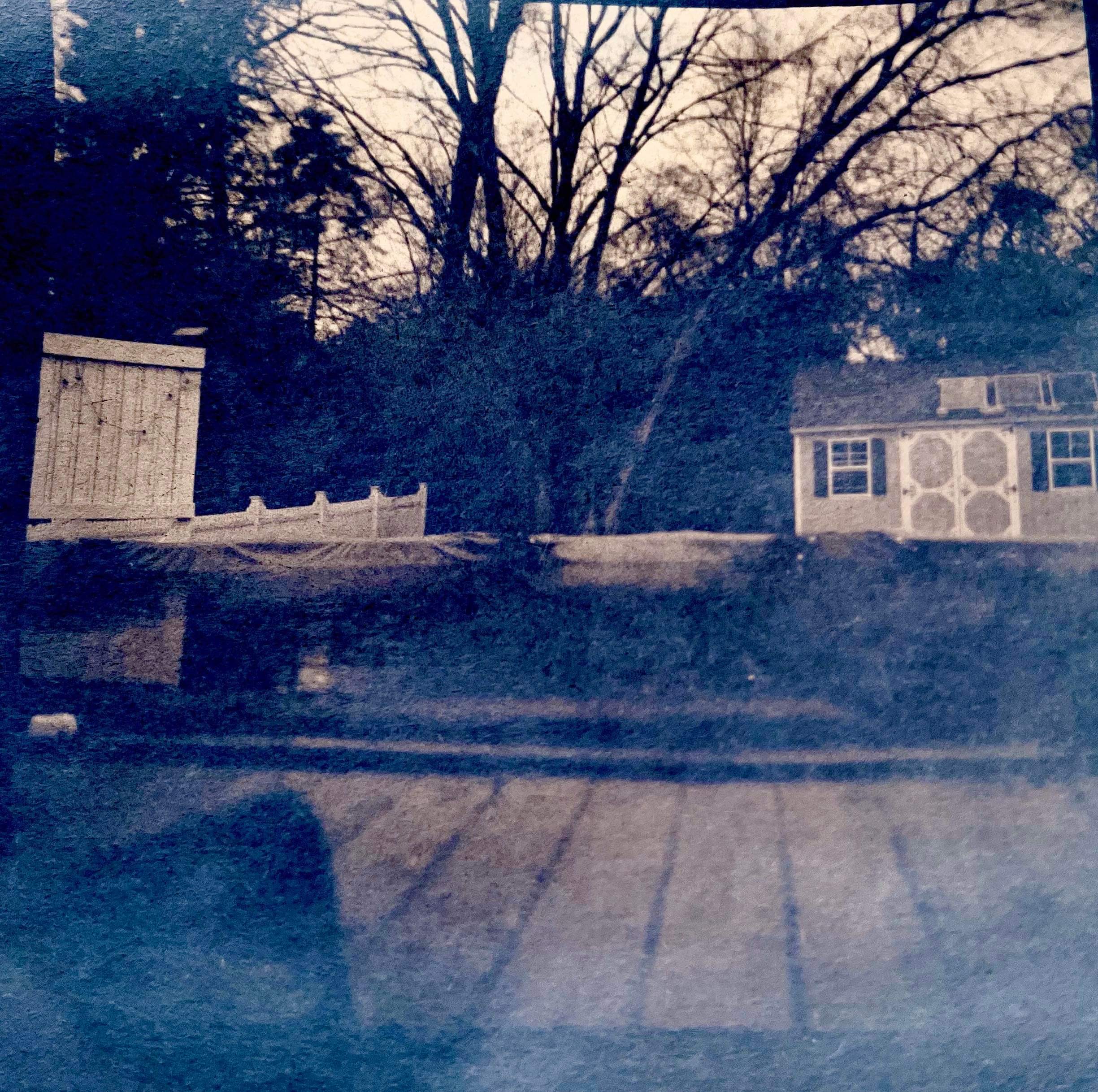

After reading this thread and some others, I decided to take a stab at it. I've been using Sun Art paper for years (mostly for hand and leaf prints), and only recently thought about placing it in a camera. I'm happy to report that I've had some limited success with it today. I took my grandfather's dusty Yashica A off the bookshelf and loaded it with a cut piece of Sun Art paper to try a 4 minute exposure indoors. No luck. I could immediately tell it was pretty far underexposed. I took it outside and did an exposure at 17 minutes and 30 seconds. It worked! I then tried a 23 minute exposure that also worked pretty well. The taking lens on this camera is a f/3.5 Yashimar 80mm, which I had wide open. It was difficult to dial in a "perfect " exposure time, due to periods of intermittent clouds in central New York today.
Can you show the results?
Here’s one from last week. Probably an 18 or 19 minute exposure. I’ll post some other examples when I unpack my gear.
A few more examples.

In-camera cyanotype (Sun Art Paper), Yashica-A, wide open, 9 hour exposure, partly cloudy day.
In-camera cyanotype (Sun Art Paper), Yashica-A, wide open, 9 hour exposure, partly cloudy day. View attachment 323226

First, I never expected I would get an exposure as good as that example, using Sun Art paper. In-camera cyanotype can be difficult, which is why I think very few people use it that way, and everyone has had a really good explanation as to why the dynamic range of the paper is extremely limited. Frankly, I was completely blown away when I pulled that paper out of the camera.
I think I was able to get much faster exposures (17-20mins) in my early tests because I had WAY more UV light and was pointing the camera at things that did a good job of reflecting it. In the example above, it was cloudy and the composition is mostly things that don't reflect UV light well, so I just let the camera sit there until the sun set.
To answer your other question, I'm not yet at the point where I have any good data. I'm still very much experimenting with the two different types of cyanotype and different cameras. So far, I don't think I have results that would surprise anyone. A good camera with a nice lens, like a Yashica-A, outperforms a Kodak Six-20 Brownie Special, which outperforms a pinhole camera, at least in terms of exposure time. And New Cyanotype on 100% cotton paper tends to get quicker exposures than pre-manufactured traditional cyanotype paper.
Yesterday morning I set more than 20 cameras up outside. It was partly cloudy here and I received a fairly wide variety of results, primarily based on whether the camera was pointing north or south. For the cameras pointing toward the sun, I got some close to interesting silhouettes. For the other cameras, not much of anything. It's been a frustrating project lately because of the short days and overcast weather here in central New York state. My current focus is to try getting good results with pinhole. I've come close a few times, but I think I need a lot more UV light than I have right now, even using New Cyanotype.

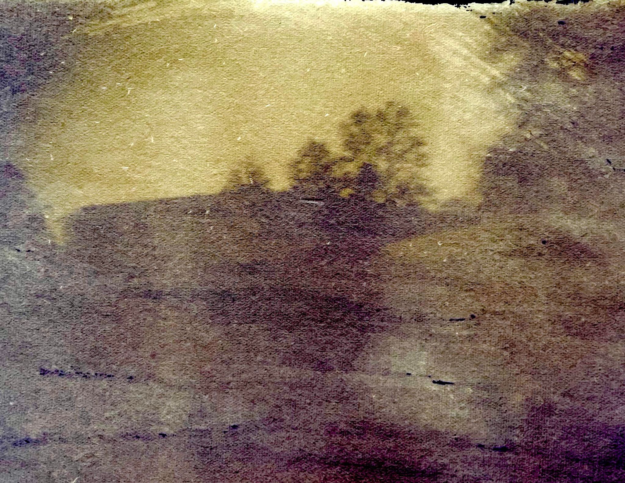

Paint bucket pinhole camera. In-camera cyanotype. ~1 month exposure.
I used the Jacquard set to prepare the paper. Great question about leaving it out for longer. I only opened the can because an animal knocked it out of place. I probably would have left it out longer otherwise. I don't yet have a good handle on reciprocity failure with cyanotype paper, but my sense is that I probably couldn't expose it for the lengths of time people are experiencing with photo paper. For this particular composition, there really isn't anything in the foreground that reflects UV light well, so it may not fill in over time.
