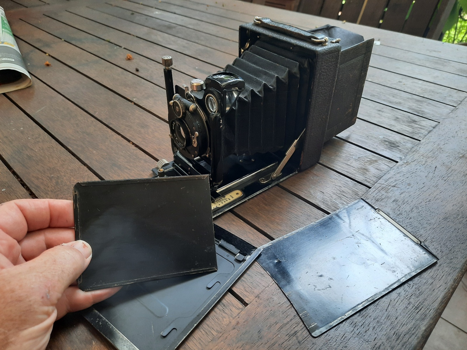

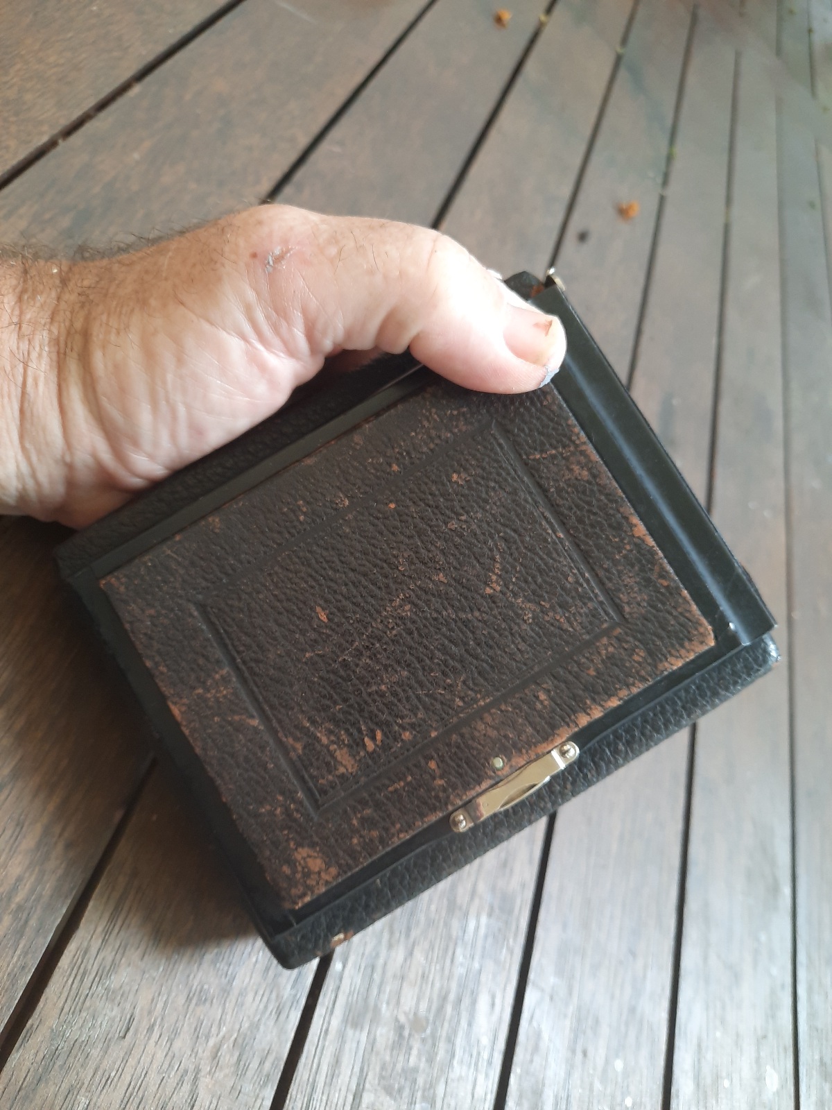

This is a folding pocket 1/4 plate camera
