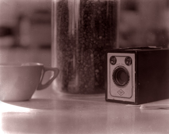

i exposed some a few weeks ago and processed it as well,
it was the iso 1250 ... and it processed filne in a split Dsumatranol-c and dektol
the film wasn't stored in some freezer vault, just a shelf the few years i owned it ...
and probably a shelf for 30 years before it was gifted to me ...
