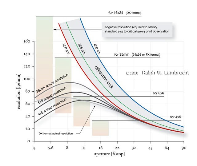

Open up a stop for each, and it matches my tests.

I don't think that works very well. If that's true my 6x6 normal lens would have a sweet spot at f/45 and my 4x5 normal lens at f/64. You are deep into diffraction with both lenses at that point. See the graph in my post above.

Diffraction is IMO, a much over-rated concern for MF and Large Format unless you are producing exceedingly large prints.
If you look at Ralfs’ excellent graph of performance v aperture, for a MF Lens it gives you a working range of f11 to f16 for critical work and f11 to f22 for standard observation.
If you have a 5x4 the operating range is even greater f16 to f32 for critical work and f16 to f45 for standard work.

... It is worth considering, if you are concerned when looking at the chart, that photographic paper can only resolve about 5 l/mm. ...
Photographic paper resolves well above this figure. I don't have targets fine enough to measure it's capability, but I know from contact printing negatives that Ilford MGIV for example, resolves at least 50 lp/mm. And why shouldn't it? Paper emulsions have a very fine grain, much finer than film.

I believe this is not the case. You can combine the absolute aperture measurement and the film distance to the lens aperture and, in fact, show that the diffraction limit does not depend on a fixed aperture value.
The diffraction limit is dictated by the Airy disk. If the lens is focused at infinity, the calculations for the radius of the Airy disc simplify to:
r = 1.22 * l * N
and the maximum lens resolution (diffraction limit) is then given by:
R = 1/r = 1 / (1.22 * l * N)
where ‘l’ is the wavelength of light, and ‘N’ is the lens aperture in f/stops.
As you can see, the diffraction limit depends on the wavelength of light and the f/stop and is not limited by an absolute aperture value.
Not the same diameter but the same f/stop (regardless of film format) creates the same amount of diffraction.

The equation for the diffraction limit, posted in #22, is totally independent of film format. The f/stop and the wavelength alone control the diffraction limit.
Diffraction is an optical phenomenon not limited to photography. Original research was done for telescopes and astronomy. The diffraction limit is a 'perfect' lens characteristic and has nothing to do with film formats.
