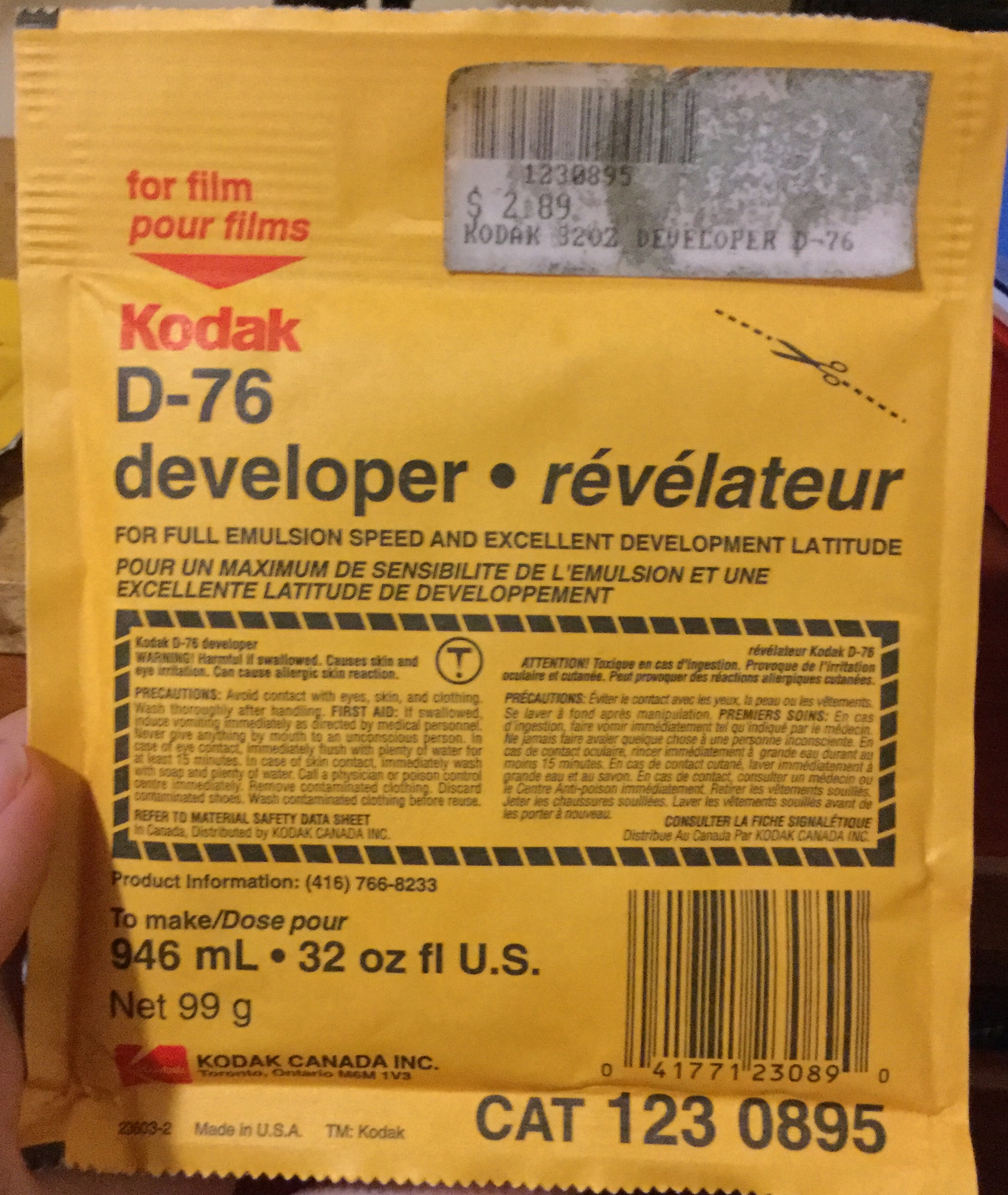

Here's a picture of the packet.

I think that the $2.89 price tag makes it quite possible that this package is older than 1989. The MSDS you linked to may very well be younger than your package.
That particular style of packaging may be the least robust of the many types over the years.
For film developer, I wouldn't risk it. Use fresh D-76 instead, and once you are fully back into the swing of things, consider some experiments with this older package.
Unless you have something reliable to compare it to, it may be hard to determine if it is working properly.

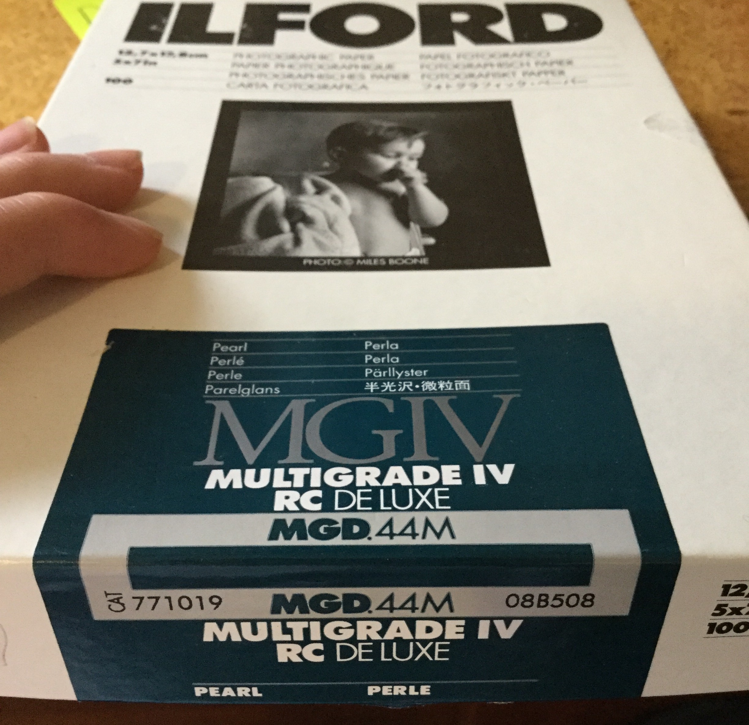

Well the paper is ilford 5x7 paper and I have 2 boxes, one box is ilford multigrade 3 RC paper and the other is ilford multigrade 4 RC paper.

The Multigrade III RC paper is quite old I have come across over the years has been problematic - usually lacking in contrast capacity, and often fogged.
This thread was from almost six years ago - note the post from Simon Galley (formerly) of Harman/Ilford: (there was a url link here which no longer exists)
Does the label on the MG IV RC say Harman or Ilford Imaging. If Ilford Imaging, it is at least 11 years old.

Hm, where exactly does it say harman/ilford imaging on the box? I can't seem to find it.
It is in very small text on the part of the label that starts on the front, wraps over the end and finishes on the back. The part that helps seal the box.

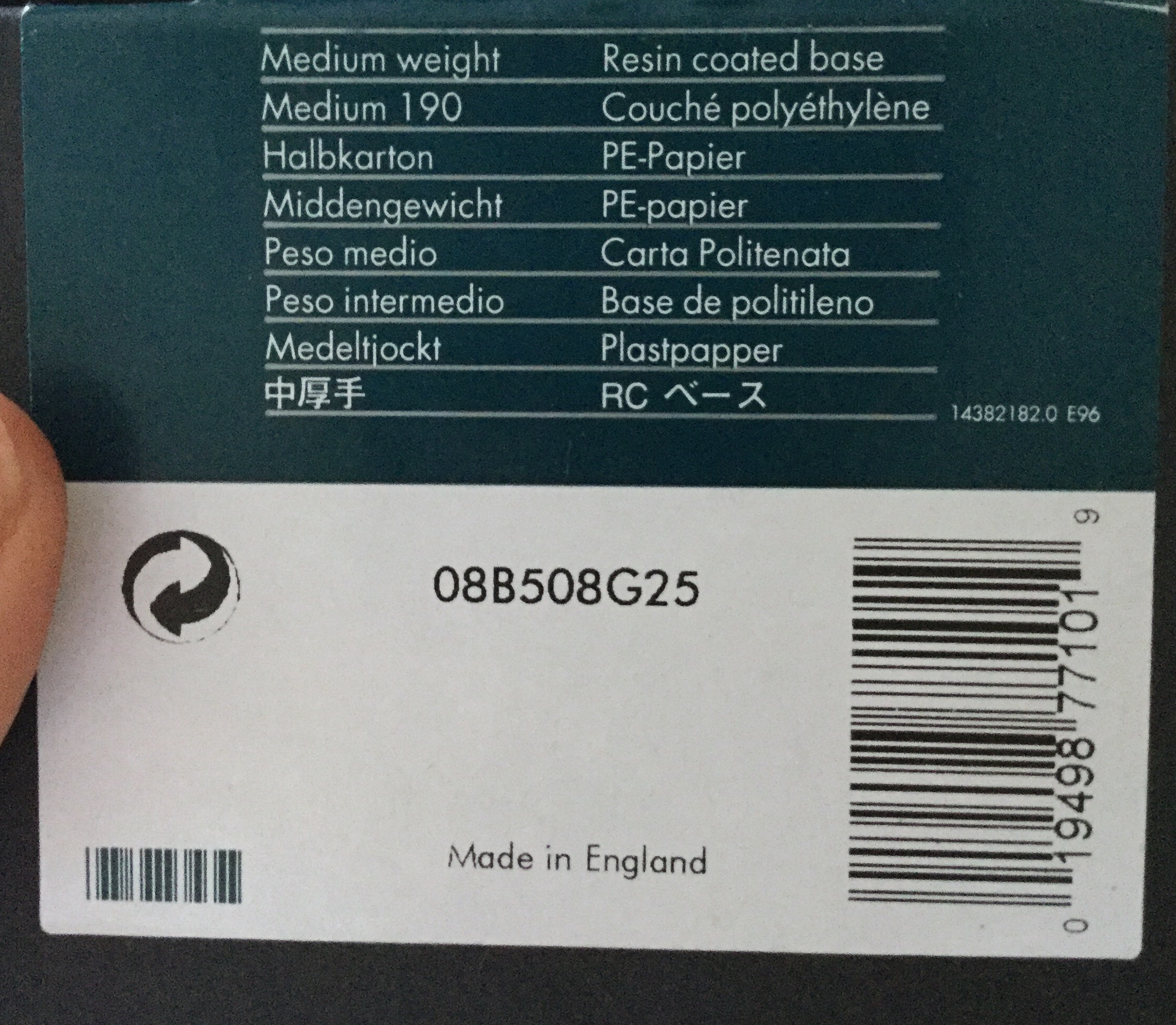

Well I'm looking on both sides of the label and I don't see harman or ilford imaging.

I've never seen one before that doesn't have either Ilford Imaging or Harman on the back.
Start a Conversation with the Harman/Ilford reps on APUG - Harman Tech Service - attach the two photos and ask them how old it might be.

I have a box of MGIV with a similar label, I was given it along with a lot of other B&W paper (mostly Kodak) by my local pr lab about 12 years ago, it wasn't new then :D I have used some and it was fine, good contrast no issues at all. It was stored in a cool darkroom.
As MGIV was introduced in 1994 your paper can't be more than 21 years old. I have a 106.7cm x 10m roll of MGIV that I bought around 1997/8 (well work bought it) I only made one print, I tested that before moving out of my last hose and it was still OK as well the label is different but then it's also significantly larger.

I got some MGIV (aprox. 15-20 years old) two weeks ago. It was stored inside a darkroom, dry and cool. Tested it, it works like a charm.
