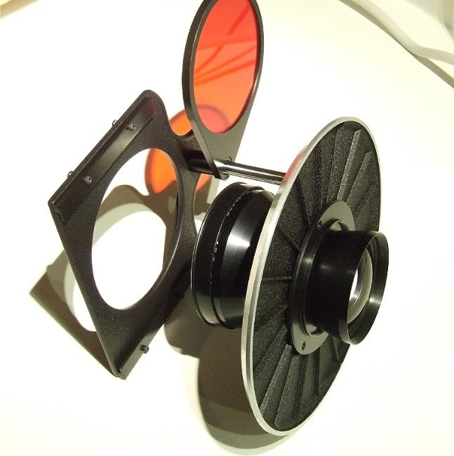

I recently bought an old Liesegang Rajah V 4x5" enlarger that hasn't got a filter drawer. I was wondering if you guys had any ideas on how to use multigrade filters with it? I currently have a box of the little under-the-lens filters from Ilford, but the holder doesn't seem to fit the enlarger as the swing-in red filter is in the way, and there is no above-the-lens filter drawer as on newer condensor machines.
You could just remove the red filter. It's handy for checking the position of the paper before making the exposure, but not entirely necessary. I've lived without one for years.

You may have to Mickey Mouse (hand make) something. Can you replace the red filter with a fitting to hold the filters? Make sure the old filters have not faded. Good luck.
Remove the red filter, and adapt the removed red filter into something that'll slide into the MG Filter holder. It's what I did on my old Omega. After a while printing, I stopped using the red filter, though, as it's not really necessary.

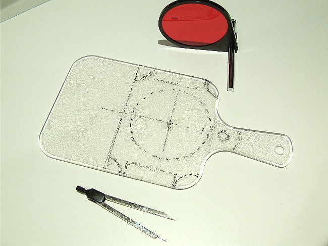

You might consider a DIY holder.(there was a url link here which no longer exists) I made for a Valoy enlarger.
In the full set of 'below the lens' filters there should be a red filter that replaces the grade filters so you can remove the original red filter with no worries.

I read somewhere about a clamp-on filter holder for the below-the-lens filters, that seems like the most ideal solution, as the type that I've seen (with the attachment that goes between the lens and the lensboard) wouldn't fit on the enlarger. Any idea where I can find one?
I made a filter holder for my 8x10 enlarger that fit on the end of the red filter holder stalk:
Nice finish on your hand-made filter holder ic-racer!
That's what I did too. I prefer to use a white piece of paper to project and focus,which I replace withthe photographic paper just prior to exposure.:blink:
I don't think I ever used the red filter on my old enlarger, so I don't have any issues with removing it. In fact, I already tried doing so, replacing it with the standard MG filter holder (I drilled a hole through it in one of the corners and used the same screw that held the red filter in place. Unfortunately the holder wasn't parallel with the lens board (it sort of "sagged"), and it also caused vignetting when using anything larger than a 6x6 negatove mask. I may have to get a shorter screw, and drill the hole more centered.
