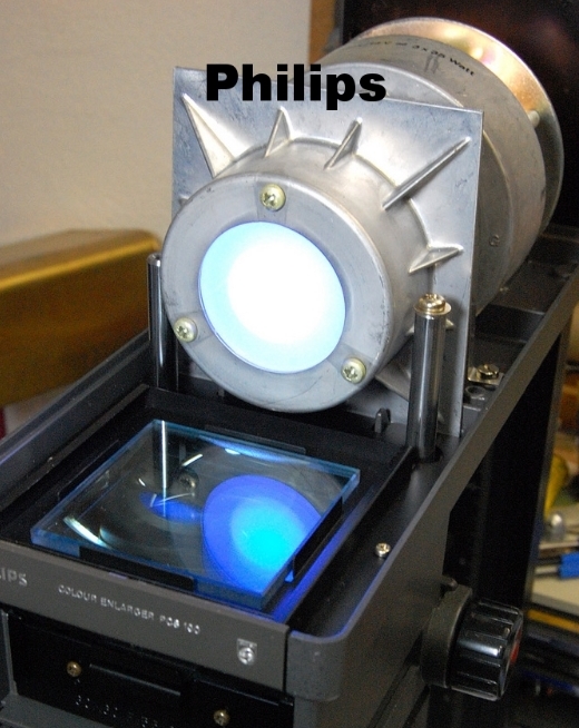

Those of you experimenting with different lamps in condenser enlargers, consider the Philips 150. That enlarger uses the lamp to project its light on a uniform disc. The disk is focused by the condensers, rather than the lamp. (mirror not shown, condensers are square).

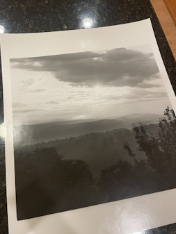

I just switched from a GE incandescent 1500w 3000k to a generic Ecosmart bright white 150w 3000k 2200 lumens bulb from Home Depot.
Using a Beseler 45m, the LED stopped my negatives from popping. Virtually no heat, much sharper and longer workflow. My ilford multigrade filters work well, but some contrast tuning is needed.
Much brighter, could probably do with a 100w, but I like the extra light. Easier to subtract than add.

Yep! I did a quick test with grades 00, 2, and 5. Got expected results.
LEDs are weird tho, they work off oscillation to give the illusion of constant light, rather than the incandescent filament. Dimmable LEDs might be the way to go. They oscillate at a variable rate, so they can handle a wider range of voltages without freaking out, but it might freak the enlarger out. Hard to know. If there’s flickering issues, I’d try both a dimmable and non-dimmable bulb

30fps is awfully fast for the human hand.
Results check out fine for me.
