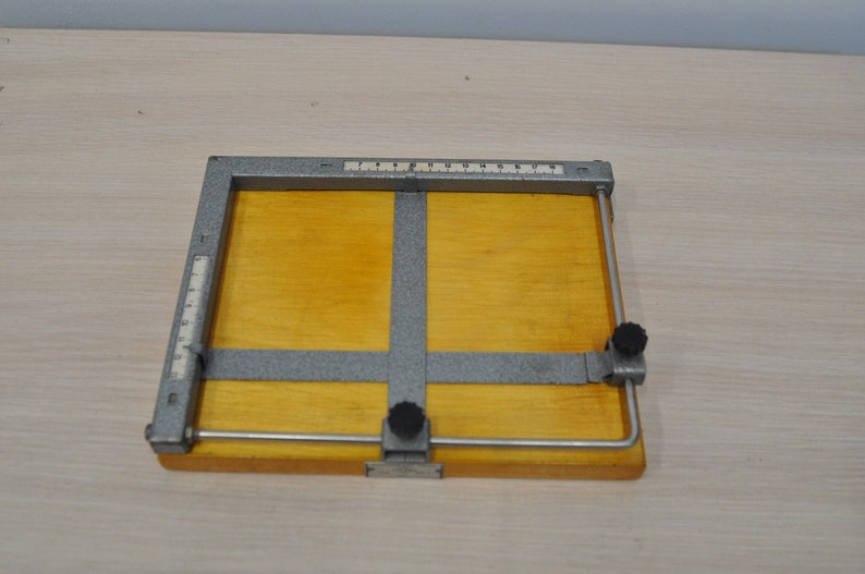

Apparently wood easels were also quite common in years gone past - this from the USSR I believe:
It is always interesting to see how that which is commonplace in this part of the Colonies, is almost unknown closer to Buckingham Palace :D
