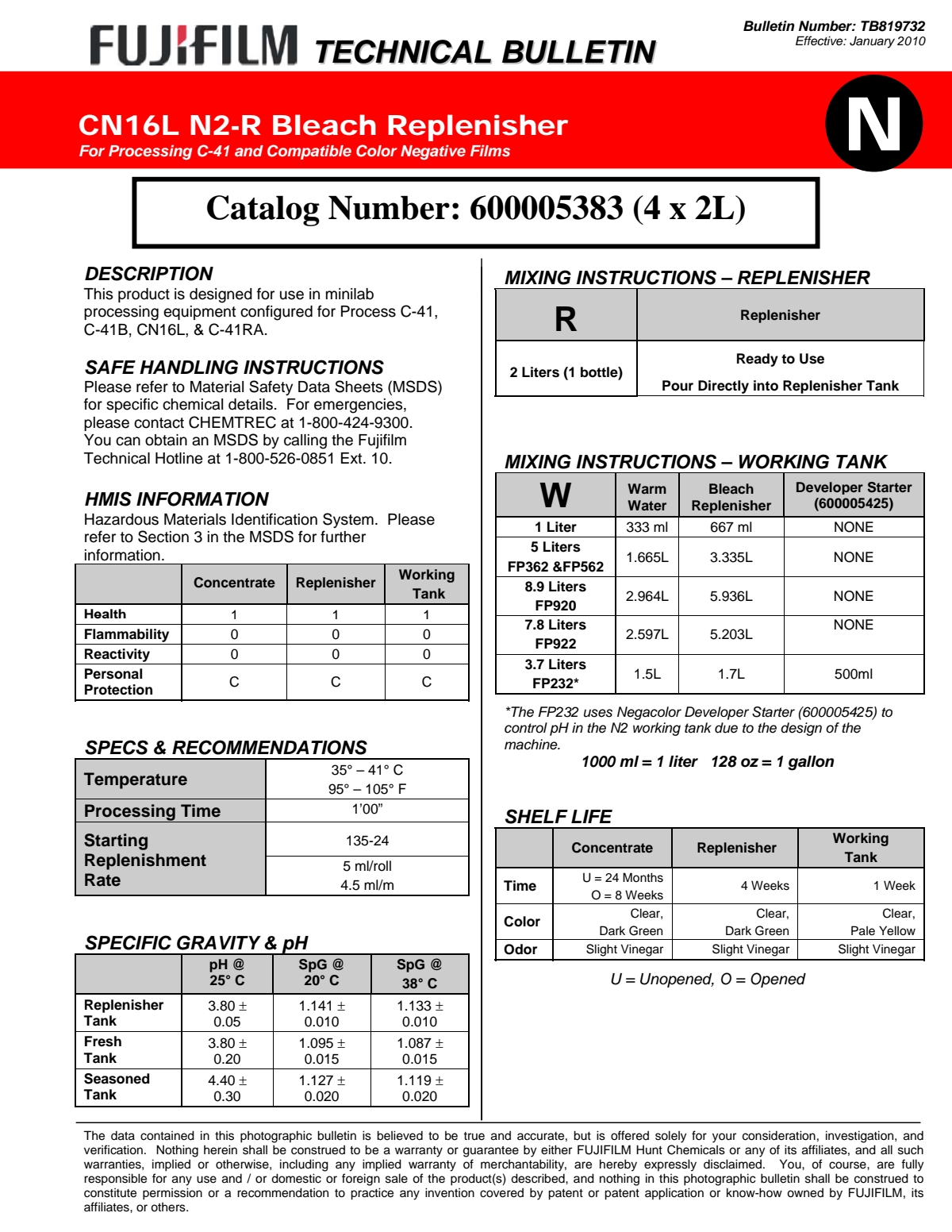

Except for the developer, all I see there is RA4 chemistry. Do you have the specific numbers for Bleach and Fixer?
Here's the bleach c41 replenisher at Pakor. Kodak uses a bleach starter, not sure how Fuji does it
Unique seems to not list as much as before I would call. Not sure if any place will sell less than case.
Everyone is feeling the supply pinch. While everyone else was panic buying toilet paper I bought chemistry.
Pakor has great customer service. Give them a call, or better yet call Fujifilm USA

Do I correctly infer from this that the bleach replenisher requires no starter and is ready to use? It looks as though 600005383 has been replaced by 600021483.
I believe this is correct. The E6 bleach has a starter, don't think there's one for C-41 bleach.
