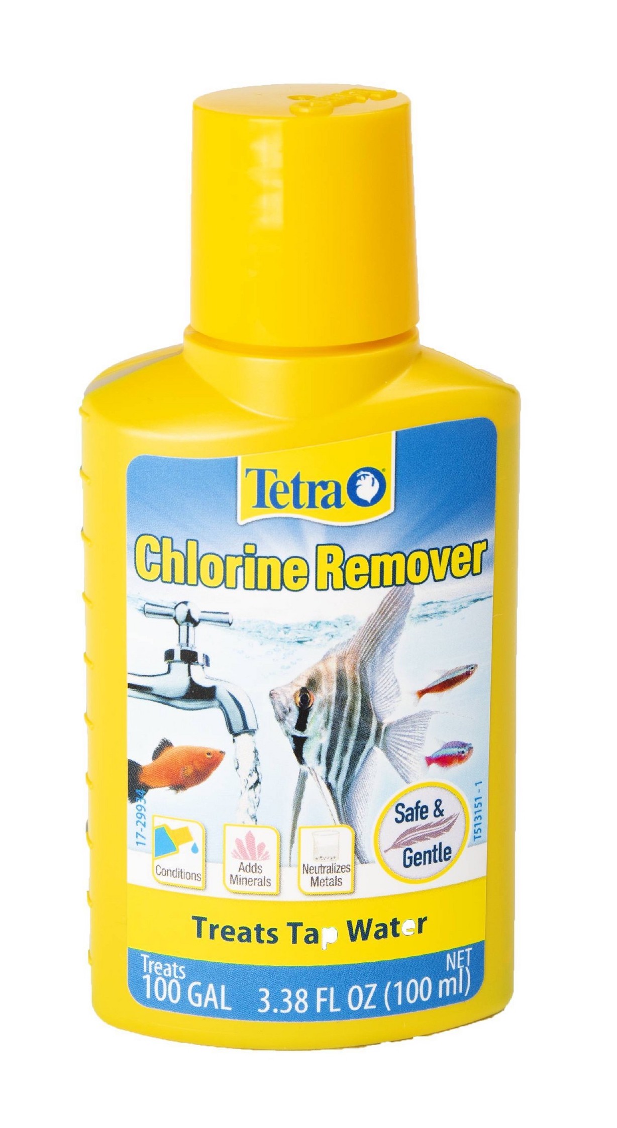

So for a while I have wanted to do a MacGyver style challenge where I develop photographic paper or film using only supplies from a department store. My plan is to make a basic Caffenol solution for development; this is easy, my greatest challenge so far has been the fixer. I spent hours researching using salt as a fixer, and even considered shampoo. My latest development in this project is that I found that fish tank chlorine remover contains Sodium Thiosulfate, the main ingredient in a photographic fixer. I picked up a bottle of it, and am ready to do some experimentation. Any advice? How much should I dilute this stuff? How should I go about testing to make sure the photos are fixed correctly?

It is a liquid solution. Sodium Thiosulfate is the first ingredient, followed by chelating compounds (metal removers) and minerals. It does not say the exact qualities.
Google says Tetra Chlorine Remover contains sodium thiosulfate, chelating compounds, and minerals. No idea how much of what. Probably cheaper to get chlorine remover from a pool or pond store. Here is the SDS for The Pond Guy Chlorine Remover:
Having watched a couple of videos about chlorine removal from fish tanks, both make the point that the cheaper way is to buy just sodium thiosulphate. So if its cheaper than the the likes of the Tetra product and there is no way of knowing what else is in such products that may or may not be suitable for film and paper fixing then it would look as if the likes of the Tetra product only has the slight benefit of being already in liquid form
If it's simply a challenge and cost plus some unknowns such as suitability are irrelevant then go ahead. Try a film leader first and see how it performs
Even if it works I am not sure how you check if the fix is permanent over the long term which might be a matter of months or years
Clearly you need to be able to translate the miniscule amount of Tetra needed for a fish tank into what is needed for film and paper so unless you can find out the concentrated quantity of "hypo" in the Tetra bottle I have no idea how you work out how much of the Tetra bottle you need for film or paper
