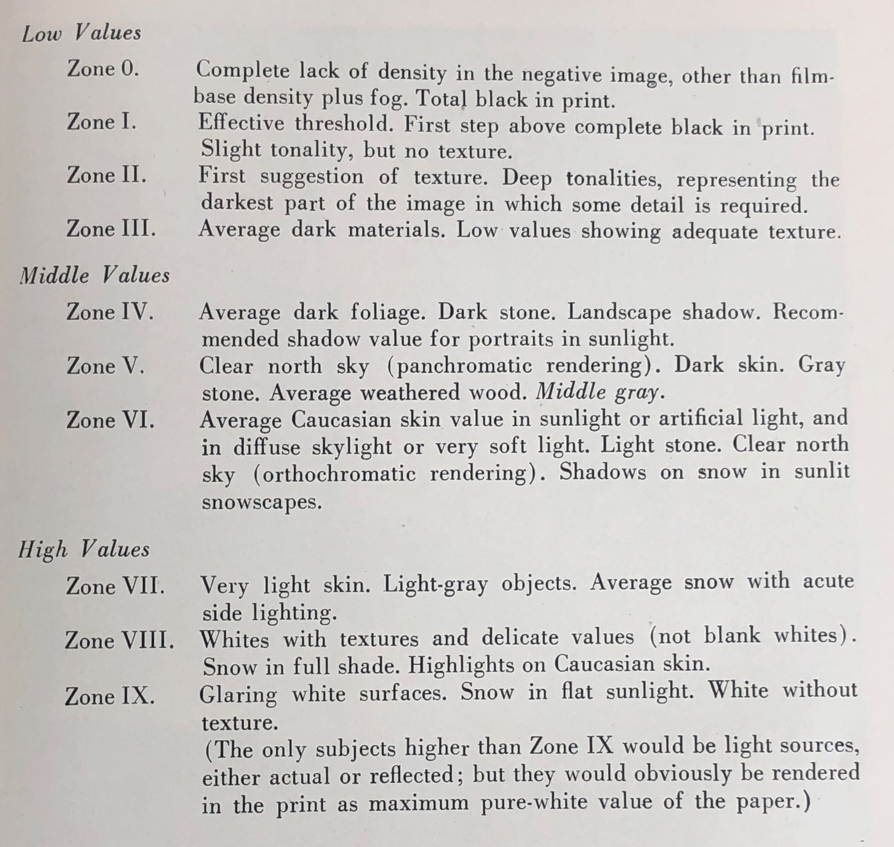

Alan, I loosely use the Zone System (Ansel would probably shame me for not adhering to the rigor he did). The Zone System is irrespective of the film or paper used to produce the final image. It's a convenient way of representing relative tonalities in the image. Therefore, film (or digital cameras) with a wider response (dynamic range) may have more subtle gradations in each particular zone than a less sensitive film/camera but the system is universal and still applicable. Here's a excerpt from Ansel Adams "The Negative" (pg.19) listing the relative meanings of the Zones:
Only a few areas in a scene need to be metered. Most photographs need a total black (Zone 0) or total white (Zone IX) to "key" the image. Additionally, the central part of the composition should have tonalities that are related appropriately to other portions of the background. Normally, you can't meter on Zone 0 (no light at all) or Zone IX (too bright) effectively. Therefore a middle tone or tones in your image must be metered. Usually a dark "something" in Zones II or III, something in the middle range (Zones IV, V, VI) and maybe a high value area (Zone VII or VIII) would be good to meter. For film, I feel Zones II & III are important as you need enough light from those areas to actually activate the emulsion. Also, the middle values are important so you render your scene appropriately. Surprisingly, you'll find that if you properly expose for shadows and your key zone(s), all the other zones will fall into place naturally. The exception is where the scene's brightness values exceed the dynamic range of your film/camera. That's where creative post-processing fits in.

Don't forget that the Zones in the Zone System mostly refer to tones in prints!
Matt, thanks for clarifying...I left a whole lot of other important details out in my effort to simplify it for the discussion here. I didn't talk about visualization of the final print which is what supposed to drive your choices during negative exposure and development when using the Zone System, etc., etc., etc.
General disclaimer to all the other readers, if you're interested in the Zone System, please look to several of the detailed sources out there vice my brief relation of the concept above.
