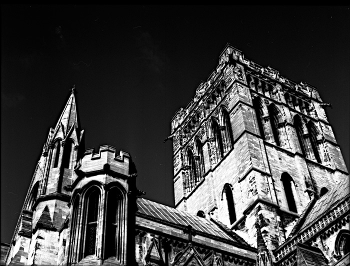

I used Dektol to develop a roll of Tech pan in the 1980's where I needed only two tones black and white :wink:
I seem to remember I rated the Tech pan at 250 but can't for the life of me remember the dilution or time for the Dektol (in those days I just gave it the time from the data sheet).

I dug up the roll.
I didn't like it much then so this is the first image from that roll:
Mark
